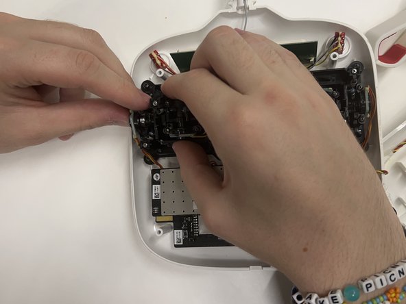

    • Inside the base housing, remove the two 9 mm screws that secure the joystick brace piece on both the left and right side of the stick.
    • Remove the braces on the left and right sides of the joystick to reach the circuit board piece on the left.
    • Detach the circuit board piece.

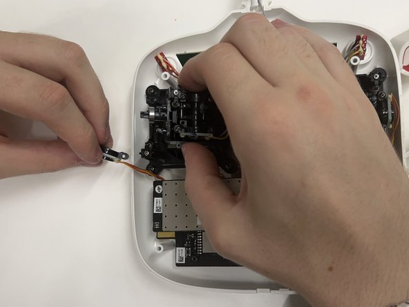

  4. DJI Phantom 3 Standard Remote Controller Joysticks Replacement: crwdns2935265:04crwdnd2935265:01crwdnd2935265:02crwdne2935265:0 DJI Phantom 3 Standard Remote Controller Joysticks Replacement: crwdns2935265:04crwdnd2935265:02crwdnd2935265:02crwdne2935265:0
    • Separate the other circuit board piece from the joystick connection using a plastic spudger.
    • The circuit board is wired through glue. If the plastic spudger is unable to pry the glue off, use the metal spudger as a last resort.
    • Take the joystick module itself and remove the four 8 mm screws that connect the joystick to the housing.
    • Unscrew the thumb stick from the module if a replacement is not needed.
  5. DJI Phantom 3 Standard Remote Controller Joysticks Replacement: crwdns2935265:05crwdnd2935265:01crwdnd2935265:01crwdne2935265:0
    • Remove the joystick.
