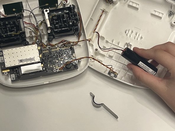

    • Position the controller so the back is facing up and the joysticks are resting on the table.
    • Remove the four 11 mm screws that secure the back plate using a Phillips #0 screwdriver.
    • Remove the back plate, being mindful of the wires still connected to the device.

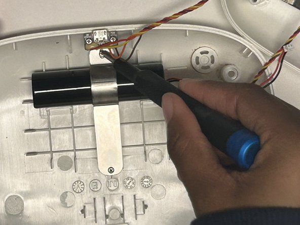

    • Remove the two 8 mm screws securing the battery to the controller using a JIS #00 screwdriver.

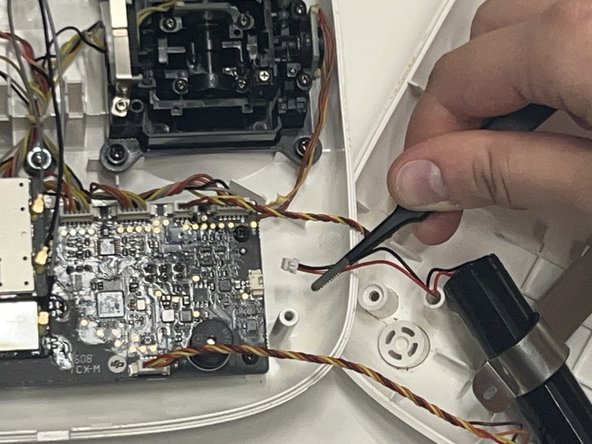

    • Use the nylon-tipped tweezers to detach the three-prong battery attachment that connects the battery to the motherboard.
    • Remove the battery.
