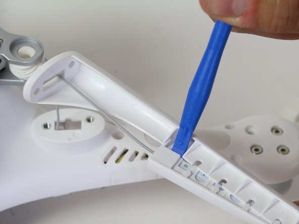

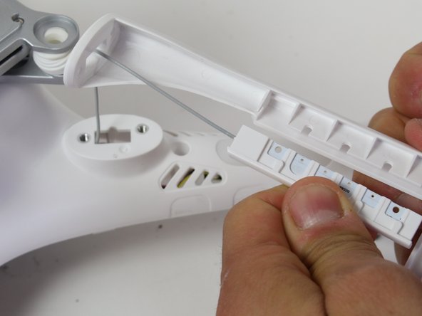

  5. DJI Phantom 3 Advanced Landing Gear Replacement: crwdns2935265:05crwdnd2935265:01crwdnd2935265:03crwdne2935265:0 DJI Phantom 3 Advanced Landing Gear Replacement: crwdns2935265:05crwdnd2935265:02crwdnd2935265:03crwdne2935265:0 DJI Phantom 3 Advanced Landing Gear Replacement: crwdns2935265:05crwdnd2935265:03crwdnd2935265:03crwdne2935265:0
    • Using a plastic opening tool, carefully separate the two pieces of plastic of the landing gear.
    • Be careful not to break the wire attached, as this is your receiver antenna.
  6. DJI Phantom 3 Advanced Landing Gear Replacement: crwdns2935265:06crwdnd2935265:01crwdnd2935265:03crwdne2935265:0 DJI Phantom 3 Advanced Landing Gear Replacement: crwdns2935265:06crwdnd2935265:02crwdnd2935265:03crwdne2935265:0 DJI Phantom 3 Advanced Landing Gear Replacement: crwdns2935265:06crwdnd2935265:03crwdnd2935265:03crwdne2935265:0
    • Feed the wire and attached plastic through the hole in the landing gear.
