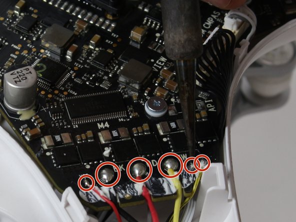

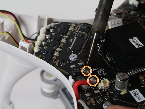

  10. DJI Phantom 3 Advanced Flight Controller Replacement: crwdns2935265:010crwdnd2935265:01crwdnd2935265:03crwdne2935265:0 DJI Phantom 3 Advanced Flight Controller Replacement: crwdns2935265:010crwdnd2935265:02crwdnd2935265:03crwdne2935265:0 DJI Phantom 3 Advanced Flight Controller Replacement: crwdns2935265:010crwdnd2935265:03crwdnd2935265:03crwdne2935265:0
    • Use a plastic opening tool to remove the glue that covers the motor and LED wires. Use a metal opening tool if necessary.
    • Desolder the six motor and LED wires where they connect on the flight controller for each arm. Refer to the Desoldering Guide on how to desolder.
    • Desolder the battery wires.

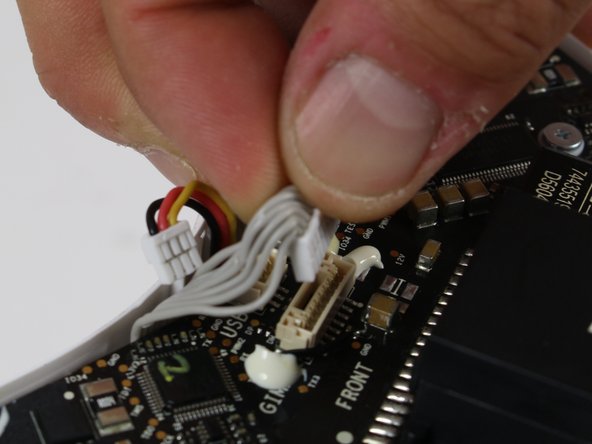

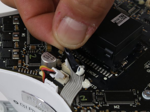

  13. DJI Phantom 3 Advanced Flight Controller Replacement: crwdns2935265:013crwdnd2935265:01crwdnd2935265:03crwdne2935265:0 DJI Phantom 3 Advanced Flight Controller Replacement: crwdns2935265:013crwdnd2935265:02crwdnd2935265:03crwdne2935265:0 DJI Phantom 3 Advanced Flight Controller Replacement: crwdns2935265:013crwdnd2935265:03crwdnd2935265:03crwdne2935265:0
    • Locate the ribbon cable that is next to the word "Front" on the flight controller.
    • Remove the small cable next to the ribbon cable by pinching on the side tab and pulling up on the connector. It has black, red and yellow wires.
    • Remove the black band from the ribbon cable.
    • Remove the ribbon cable by pinching on the side tab and pulling up on the connector.
