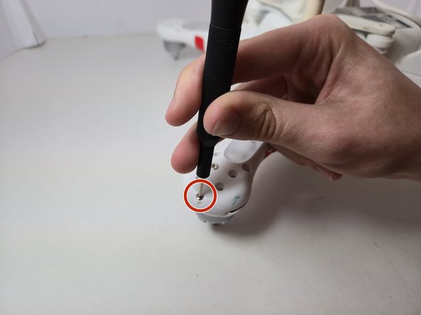

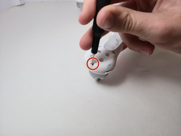

  5. DJI Phantom 2 Vision DJI Phantom 2 Vision Motor Replacement Replacement: crwdns2935265:05crwdnd2935265:01crwdnd2935265:03crwdne2935265:0 DJI Phantom 2 Vision DJI Phantom 2 Vision Motor Replacement Replacement: crwdns2935265:05crwdnd2935265:02crwdnd2935265:03crwdne2935265:0 DJI Phantom 2 Vision DJI Phantom 2 Vision Motor Replacement Replacement: crwdns2935265:05crwdnd2935265:03crwdnd2935265:03crwdne2935265:0
    • Remove the 4 hex screws(9mm) using a #2 Allen head bit, under the motor on each arm of the drone, then the 2 hex screws (6mm) next to those previous 4.
    • Remove the final hex screw(9mm) using #2 located next to the landing gear legs, then use a screwdriver to remove the 1 Philips head screw(9mm) on each arm using a 00 Philips Bit head.
    • The total number of screws should be 28

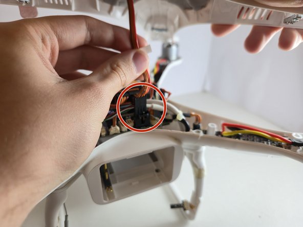

  6. DJI Phantom 2 Vision DJI Phantom 2 Vision Motor Replacement Replacement: crwdns2935265:06crwdnd2935265:01crwdnd2935265:02crwdne2935265:0 DJI Phantom 2 Vision DJI Phantom 2 Vision Motor Replacement Replacement: crwdns2935265:06crwdnd2935265:02crwdnd2935265:02crwdne2935265:0
    • Remove the top cover of the Phantom Vision drone.
    • Disconnect the GPS wire from the motherboard. It should easily disconnect with little force.
