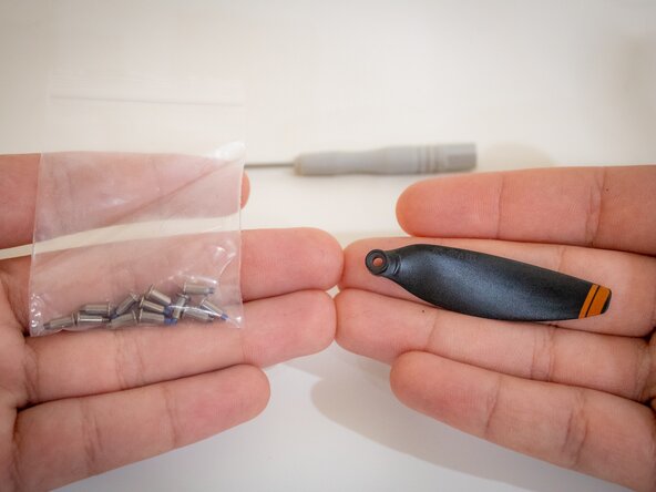

    • Determine whether the propeller to be replaced is a Type A or Type B propeller.
    • The A propellers have a small notch that distinguishes them from the B propellers as depicted in the photo.
    • Order a new set of the corresponding propellers.
    • Order the DJI branded propellers for the best performance.

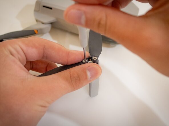

    • Unscrew the screw connecting the corresponding propeller to the motor by using the screwdriver in a counter-clockwise manner.

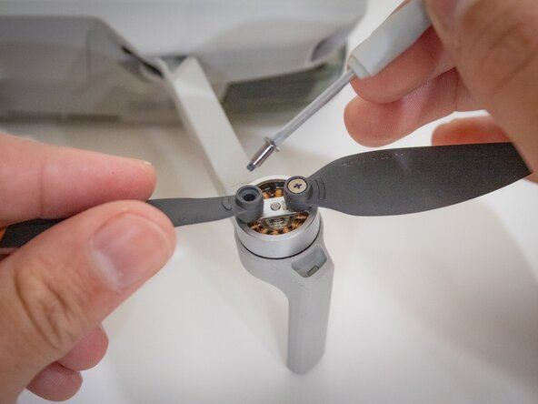

    • Remove the old propeller from the motor.
  5. DJI Mini 2 SE Propeller Replacement: crwdns2935265:05crwdnd2935265:01crwdnd2935265:02crwdne2935265:0 DJI Mini 2 SE Propeller Replacement: crwdns2935265:05crwdnd2935265:02crwdnd2935265:02crwdne2935265:0
    • Screw in the new propeller by using the screwdriver in a clock-wise manner.
    • It is recommended to use a new screw.
    • Tighten screw fully to ensure safety during flight.
