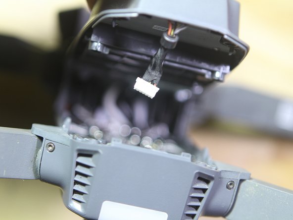

  7. DJI Mavic Pro Top Case Removal, Disconnect GPS From Logic Board: crwdns2935265:07crwdnd2935265:01crwdnd2935265:03crwdne2935265:0 DJI Mavic Pro Top Case Removal, Disconnect GPS From Logic Board: crwdns2935265:07crwdnd2935265:02crwdnd2935265:03crwdne2935265:0 DJI Mavic Pro Top Case Removal, Disconnect GPS From Logic Board: crwdns2935265:07crwdnd2935265:03crwdnd2935265:03crwdne2935265:0
    • Gently lift up the rear of the top case .5-1mm, and insert a pair of tweezers, grab the black cloth shielded cable connecting the top and bottom, and gently pull it up and away from the bottom board. The rear should lift freely up from the case 2-3mm.

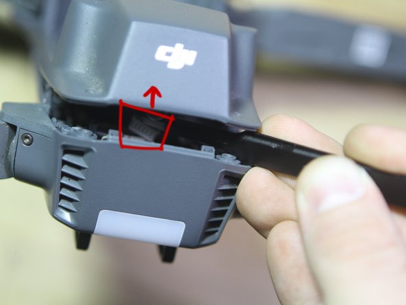

  8. DJI Mavic Pro Top Case Removal, Remove Front End of Top Cover: crwdns2935265:08crwdnd2935265:01crwdnd2935265:01crwdne2935265:0
    • Insert your metal spudger in between the top and bottom case on both the left and right sides of the drone, as shown in the photo. Pry up gently until it is free.
  9. DJI Mavic Pro Top Case Removal, Unhinge Front Edge of Top Cover: crwdns2935265:09crwdnd2935265:01crwdnd2935265:02crwdne2935265:0 DJI Mavic Pro Top Case Removal, Unhinge Front Edge of Top Cover: crwdns2935265:09crwdnd2935265:02crwdnd2935265:02crwdne2935265:0
    • This part is tricky. There are four clips folding the front edge in place. Half are facing one direction and half are facing he opposite direction. Be gentle and careful when disengaging them. The photos here, show the locations and directions of the clips.
    In the step 9 the two clips at middle can be opened by prying from the bottom through the two sqare holes in front of the gimble (picture at step 4). But be careful as there is a small circuit at the centre. Put in a small flat screw driver and push the clip towards the back of the drone.

I guess it’s going to be difficult to insert the GPS cable again.
Juan - crwdns2934203:0crwdne2934203:0
Actually you can reconnect it before you start clipping the case into place, you just have to be careful and gentle with it.

I have broken one of the wires of the piug in under the shell that goes to the gps on mavic pro can it be bought seperate
John Hinckle - crwdns2934203:0crwdne2934203:0
I have broken one of the wires of the plug in under the shell that goes to the gps on the mavic pro can it be bought seperate
John Hinckle -
Yes it can just look up mavic gps module or something of the sort.
