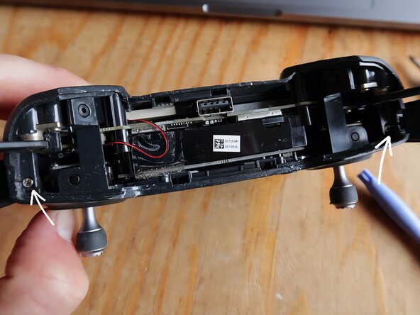

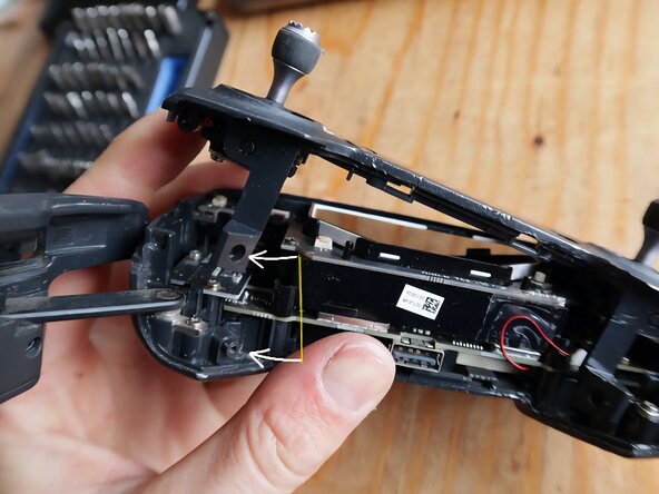

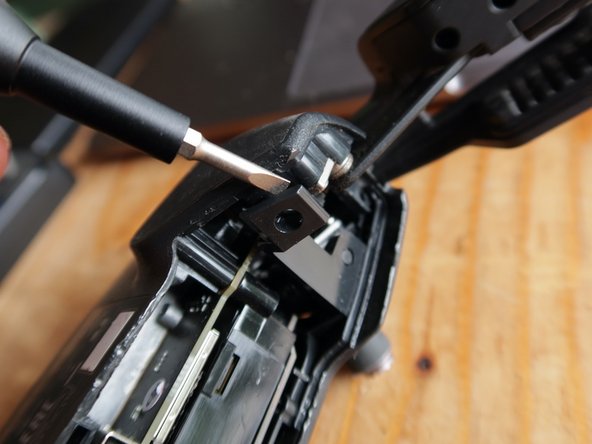

  7. DJI Mavic Pro Controller Micro USB Port Replacement, Remove the front panel: crwdns2935265:07crwdnd2935265:01crwdnd2935265:03crwdne2935265:0 DJI Mavic Pro Controller Micro USB Port Replacement, Remove the front panel: crwdns2935265:07crwdnd2935265:02crwdnd2935265:03crwdne2935265:0 DJI Mavic Pro Controller Micro USB Port Replacement, Remove the front panel: crwdns2935265:07crwdnd2935265:03crwdnd2935265:03crwdne2935265:0
    • First remove the 2 phillips screws on at the top corners. There are 2 places where the front panels locks on the controller. (those big round things) Just pull it of there and you can open up the controller and remove the panel
  8. DJI Mavic Pro Controller Micro USB Port Replacement, Open the controller: crwdns2935265:08crwdnd2935265:01crwdnd2935265:02crwdne2935265:0 DJI Mavic Pro Controller Micro USB Port Replacement, Open the controller: crwdns2935265:08crwdnd2935265:02crwdnd2935265:02crwdne2935265:0
    • Now the controller is open, you can see the part you need to replace, just a few steps away
