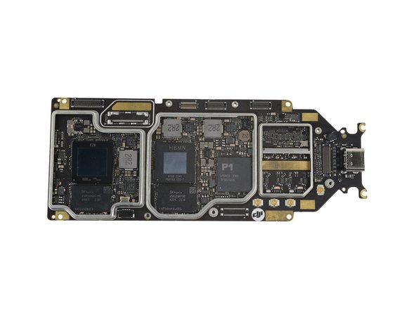

  1. DJI Mavic 3 Pro Chip ID, Drone Main Board Side A: crwdns2935265:01crwdnd2935265:01crwdnd2935265:02crwdne2935265:0 DJI Mavic 3 Pro Chip ID, Drone Main Board Side A: crwdns2935265:01crwdnd2935265:02crwdnd2935265:02crwdne2935265:0
    • Likely Leadcore H6MN applications processor
    • Likely Leadcore E2B video processor
    • Likely Leadcore P1 applications & baseband processor
    • SK Hynix H9HCNNNBKMMLXR-NEE 2 GB LPDDR4X SDRAM memory
    • SK Hynix H54G38AYRBX259 1 GB LPDDR4 SDRAM memory
    • Texas Instruments BQ24179 buck-boost battery charger
    • Richtek RT1715 USB Type-C power delivery controller
