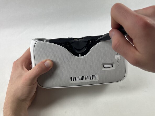

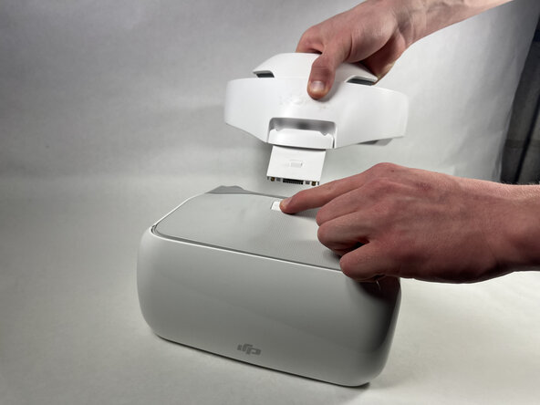

    • Place the headset on a stable surface.
    • Press down on the white button located at the top of the headset until you hear a click.
    • Lift the the headband.

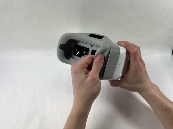

    • Orient the headset so that the lenses are facing you.
    • Starting at the edge of the headset, gently lift the silicon mask until you hear a click.
    • The clicking is caused by popping out the connectors and not due to damage.
    • Continue this process along the edge of the mask.

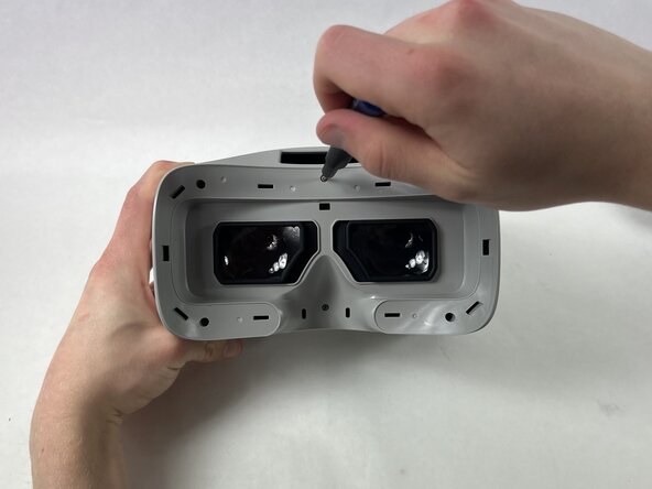

  3. DJI Goggles Lenses Replacement: crwdns2935265:03crwdnd2935265:01crwdnd2935265:03crwdne2935265:0 DJI Goggles Lenses Replacement: crwdns2935265:03crwdnd2935265:02crwdnd2935265:03crwdne2935265:0 DJI Goggles Lenses Replacement: crwdns2935265:03crwdnd2935265:03crwdnd2935265:03crwdne2935265:0
    • Remove six 3mm Phillips #00 screws.

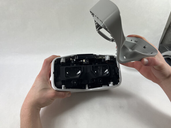

  4. DJI Goggles Lenses Replacement: crwdns2935265:04crwdnd2935265:01crwdnd2935265:02crwdne2935265:0 DJI Goggles Lenses Replacement: crwdns2935265:04crwdnd2935265:02crwdnd2935265:02crwdne2935265:0
    • Remove two 3mm Phillips #00 screws.

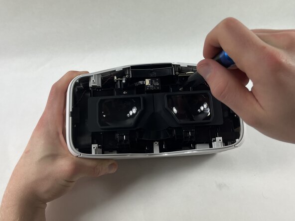

  5. DJI Goggles Lenses Replacement: crwdns2935265:05crwdnd2935265:01crwdnd2935265:02crwdne2935265:0 DJI Goggles Lenses Replacement: crwdns2935265:05crwdnd2935265:02crwdnd2935265:02crwdne2935265:0
    • Remove two 3mm Hex screws.

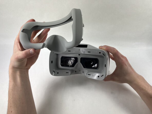

  6. DJI Goggles Lenses Replacement: crwdns2935265:06crwdnd2935265:01crwdnd2935265:01crwdne2935265:0
    • Pinch the rubber between the lenses and lift.
    • Try not to touch lenses on replacement.
