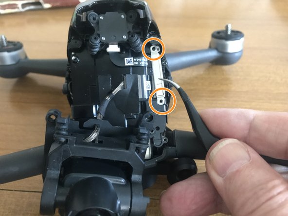

  10. DJI FPV Drone Disassembly, Removing the GPS module: crwdns2935265:010crwdnd2935265:01crwdnd2935265:02crwdne2935265:0 DJI FPV Drone Disassembly, Removing the GPS module: crwdns2935265:010crwdnd2935265:02crwdnd2935265:02crwdne2935265:0
    • Lift off the the GPS U.FL antenna connectors.
    • Remove a screw on either side of the GPS unit. These have very fine Phillips heads, smaller than 000. One of the heads may be covered with a black coating which should be scraped off
    • Remove the retainer clip which the screw on the right secured. The top of the clip is held by the board.
    • Lift off the connector which the clip retained. You can now remove the GPS unit.

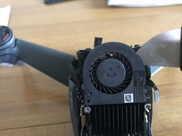

  11. DJI FPV Drone Disassembly, Removing the fan: crwdns2935265:011crwdnd2935265:01crwdnd2935265:02crwdne2935265:0 DJI FPV Drone Disassembly, Removing the fan: crwdns2935265:011crwdnd2935265:02crwdnd2935265:02crwdne2935265:0
    • Disconnect the fan connector.
    • The fan is retained by double-sided tape and can now be prised off with a jimmy under the top edge.

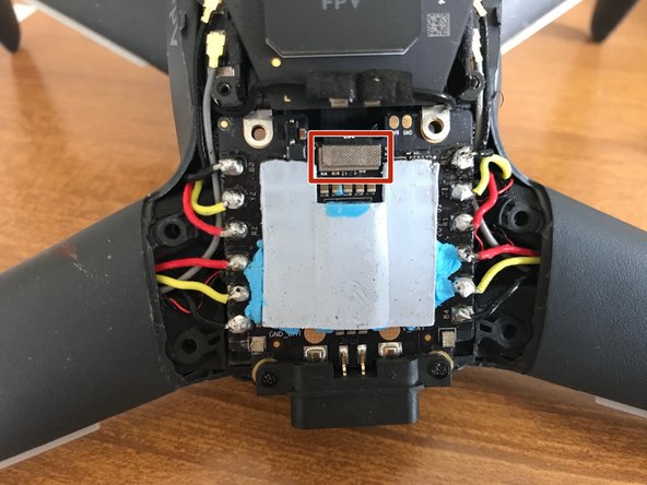

  12. DJI FPV Drone Disassembly, Disconnecting the motor control board: crwdns2935265:012crwdnd2935265:01crwdnd2935265:02crwdne2935265:0 DJI FPV Drone Disassembly, Disconnecting the motor control board: crwdns2935265:012crwdnd2935265:02crwdnd2935265:02crwdne2935265:0
    • Each of the 4 motors has 3 wires soldered to the motor control board. The colours should be the same as in the photo. Were you to accidentally reverse any two on reconnecting them, the corresponding motor would spin backwards, causing an instant crash on take-off.
    • Unsolder all 12 wires (or only the 6 on one side if you are simply replacing an arm).
    • Lead-free solder requires an extra hot iron to melt. It will melt much more easily if you add a little leaded solder. This will not only increase the thermal contact between the iron and the lead-free solder, but will also reduce its melting point as the solders mix. Use a solder sucker or solder wick to remove excess solder before reconnecting.
    • Lift off the connector at the top of the motor control board.
    • On reassembly, double check that this connector is fully engaged and pressed home (force is not required). If not fully engaged, you may find the drone appears completely dead. At the end of a couple of hours of intensive work on your precious toy this can cause an unpleasant sinking feeling in the pit of the stomach.

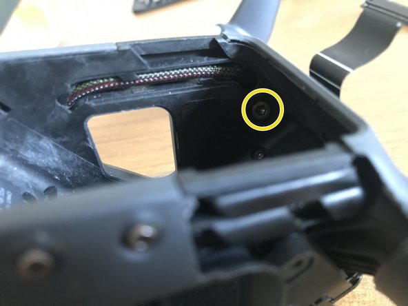

  14. DJI FPV Drone Disassembly, Rear arm removal: crwdns2935265:014crwdnd2935265:01crwdnd2935265:02crwdne2935265:0 DJI FPV Drone Disassembly, Rear arm removal: crwdns2935265:014crwdnd2935265:02crwdnd2935265:02crwdne2935265:0
    • This is necessary even if you only need to replace a front arm.
    • Remove 2 screws securing a rear arm on each side (or only on the side of an arm you are replacing).
    • Remove the screw accessed from within the battery compartment retaining each rear arm. These have 2.5mm hex heads and were previously loosened.
    • You should now be able to gently ease off the rear arms.

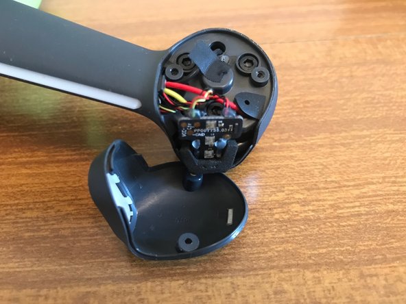

  16. DJI FPV Drone Disassembly, Arm disassembly: crwdns2935265:016crwdnd2935265:01crwdnd2935265:03crwdne2935265:0 DJI FPV Drone Disassembly, Arm disassembly: crwdns2935265:016crwdnd2935265:02crwdnd2935265:03crwdne2935265:0 DJI FPV Drone Disassembly, Arm disassembly: crwdns2935265:016crwdnd2935265:03crwdnd2935265:03crwdne2935265:0
    • Both the front and rear arms have covers on the bottom secured by two screws. Remove these screws.
    • In the case of the front arm there is a small board next to the motor with 3 connectors. One receives LED power from the motor control board, a second connects to a LED within the arm itself, and the third is a U.FL antenna connector. Disconnct all three if you need to transfer the board to a replacement arm.
    • The front arms are similar except that a somewhat larger board extends into the leg.
