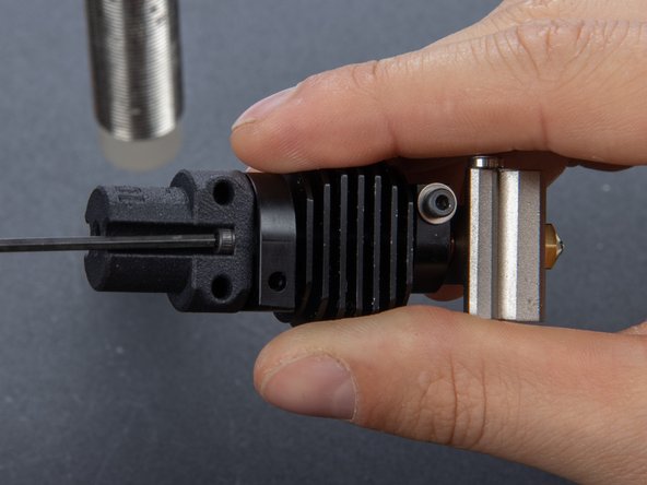

  1. DDX/ Copperhead Hotend Installation, Prepare Copperhead™ Adapter: crwdns2935265:01crwdnd2935265:01crwdnd2935265:03crwdne2935265:0 DDX/ Copperhead Hotend Installation, Prepare Copperhead™ Adapter: crwdns2935265:01crwdnd2935265:02crwdnd2935265:03crwdne2935265:0 DDX/ Copperhead Hotend Installation, Prepare Copperhead™ Adapter: crwdns2935265:01crwdnd2935265:03crwdnd2935265:03crwdne2935265:0
    • Use 2x 2.5x6mm screws supplied with the Copperhead™ hotend.
    • Insert them in the mounting holes.

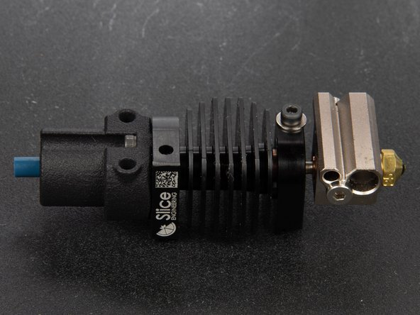

  2. DDX/ Copperhead Hotend Installation, Attach Adapter To Hotend: crwdns2935265:02crwdnd2935265:01crwdnd2935265:02crwdne2935265:0 DDX/ Copperhead Hotend Installation, Attach Adapter To Hotend: crwdns2935265:02crwdnd2935265:02crwdnd2935265:02crwdne2935265:0
    • Attach Adapter and hotend.
    • New lineNotice the orientation of the Adapter and Hot Block.
    • These indented marks should be oriented towards the front of the DDX.
    • The fixation screws that attach the DDX to the carriage plate will enter through them.

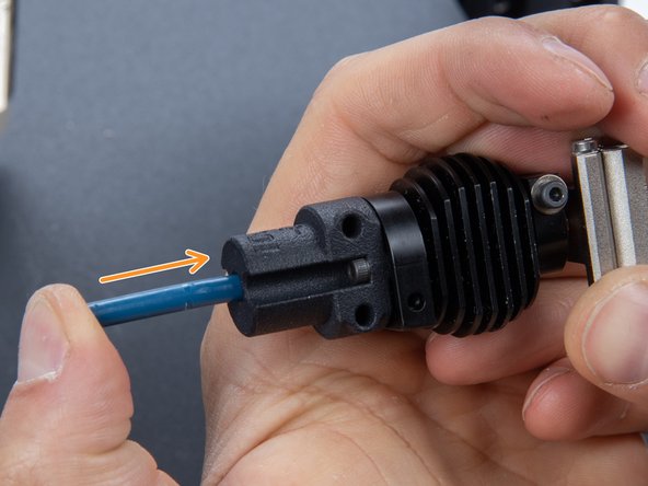

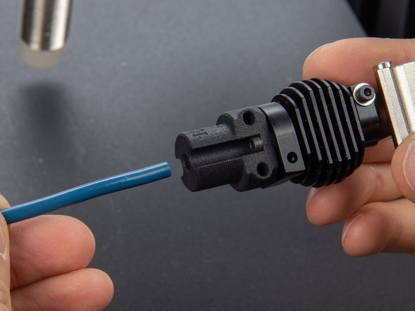

  3. DDX/ Copperhead Hotend Installation, Prepare PTFE Tube: crwdns2935265:03crwdnd2935265:01crwdnd2935265:03crwdne2935265:0 DDX/ Copperhead Hotend Installation, Prepare PTFE Tube: crwdns2935265:03crwdnd2935265:02crwdnd2935265:03crwdne2935265:0 DDX/ Copperhead Hotend Installation, Prepare PTFE Tube: crwdns2935265:03crwdnd2935265:03crwdnd2935265:03crwdne2935265:0
    • Insert the Capricorn tube inside the Adapter and hotend.
    • Push hard until it hits the bottom.
    • Download the PTFE cutting fixture

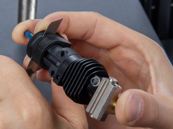

  4. DDX/ Copperhead Hotend Installation, Cut PTFE Tube To Spec: crwdns2935265:04crwdnd2935265:01crwdnd2935265:03crwdne2935265:0 DDX/ Copperhead Hotend Installation, Cut PTFE Tube To Spec: crwdns2935265:04crwdnd2935265:02crwdnd2935265:03crwdne2935265:0 DDX/ Copperhead Hotend Installation, Cut PTFE Tube To Spec: crwdns2935265:04crwdnd2935265:03crwdnd2935265:03crwdne2935265:0
    • Insert the Capricorn tube in the cutting fixture
    • Drive it until it fits the Adapter
    • Pressing all together use the hobby knife to cut the tube straight.
    • At the end, the Capricorn should stand out about 5mm.

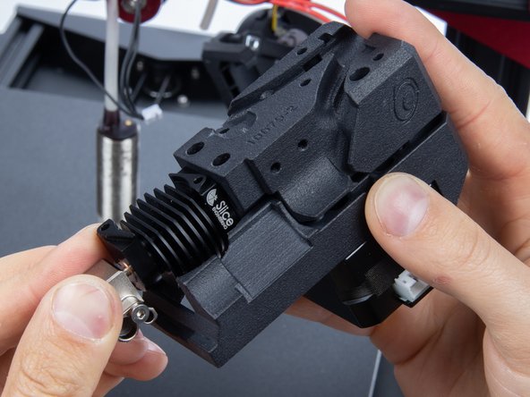

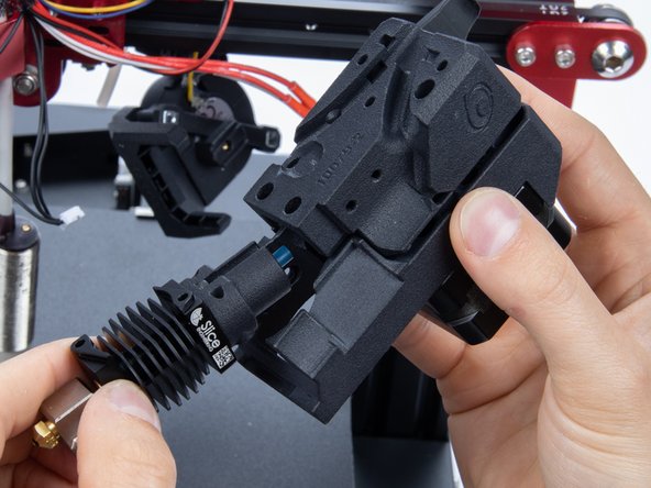

  5. DDX/ Copperhead Hotend Installation, Insert Copperhead™ Into DDX: crwdns2935265:05crwdnd2935265:01crwdnd2935265:03crwdne2935265:0 DDX/ Copperhead Hotend Installation, Insert Copperhead™ Into DDX: crwdns2935265:05crwdnd2935265:02crwdnd2935265:03crwdne2935265:0 DDX/ Copperhead Hotend Installation, Insert Copperhead™ Into DDX: crwdns2935265:05crwdnd2935265:03crwdnd2935265:03crwdne2935265:0
    • Spread the housing apart from 2 to 3mm
    • Insert the Copperhead™ in at an angle.
    • Push it until the mounting holes align.

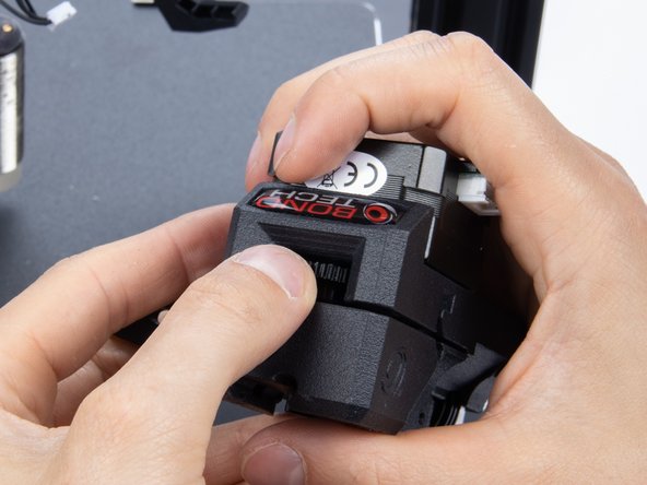

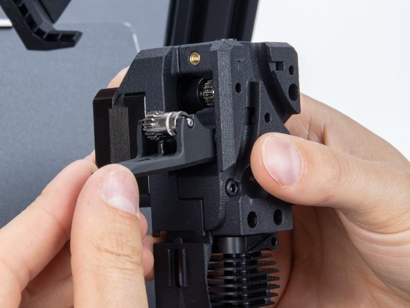

  6. DDX/ Copperhead Hotend Installation, Close DDX 1/2: crwdns2935265:06crwdnd2935265:01crwdnd2935265:03crwdne2935265:0 DDX/ Copperhead Hotend Installation, Close DDX 1/2: crwdns2935265:06crwdnd2935265:02crwdnd2935265:03crwdne2935265:0 DDX/ Copperhead Hotend Installation, Close DDX 1/2: crwdns2935265:06crwdnd2935265:03crwdnd2935265:03crwdne2935265:0
    • If when clamping the DDX the gears collide:
    • Release the thumbscrew.
    • Open the hinge.
    • Clamp both halves while rotating the main gear back and forth.

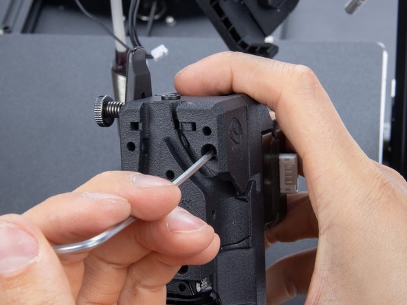

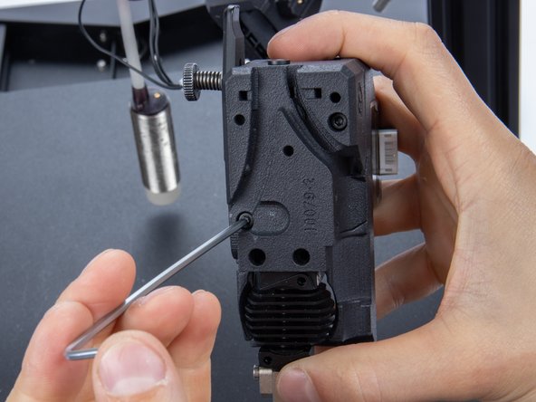

  7. DDX/ Copperhead Hotend Installation, Close DDX 2/2: crwdns2935265:07crwdnd2935265:01crwdnd2935265:03crwdne2935265:0 DDX/ Copperhead Hotend Installation, Close DDX 2/2: crwdns2935265:07crwdnd2935265:02crwdnd2935265:03crwdne2935265:0 DDX/ Copperhead Hotend Installation, Close DDX 2/2: crwdns2935265:07crwdnd2935265:03crwdnd2935265:03crwdne2935265:0
    • When the DDX closes down verify the mounting holes alignment.
    • Screw the back screws to close it.
