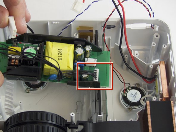

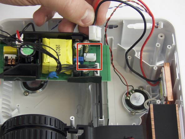

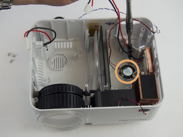

    • Remove wires attaching the piezoelectric speakers to the motherboard.
  10. DBPOWER T20 Speaker Replacement: crwdns2935265:010crwdnd2935265:01crwdnd2935265:02crwdne2935265:0 DBPOWER T20 Speaker Replacement: crwdns2935265:010crwdnd2935265:02crwdnd2935265:02crwdne2935265:0
    • Remove the five screws securing the black plastic cover with a J0 screwdriver.
    • Lift up and out to remove.

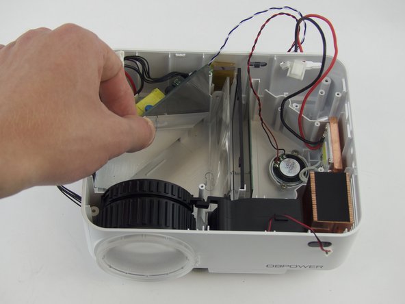

  11. DBPOWER T20 Speaker Replacement, Speaker: crwdns2935265:011crwdnd2935265:01crwdnd2935265:02crwdne2935265:0 DBPOWER T20 Speaker Replacement, Speaker: crwdns2935265:011crwdnd2935265:02crwdnd2935265:02crwdne2935265:0
    • Remove the two (3 mm) screws connecting the bracket down and pull out the reflector, using a J0 Philips Head Screwdriver.

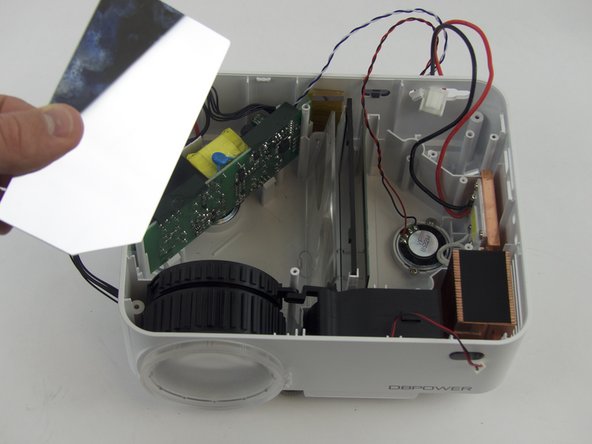

  12. DBPOWER T20 Speaker Replacement: crwdns2935265:012crwdnd2935265:01crwdnd2935265:03crwdne2935265:0 DBPOWER T20 Speaker Replacement: crwdns2935265:012crwdnd2935265:02crwdnd2935265:03crwdne2935265:0 DBPOWER T20 Speaker Replacement: crwdns2935265:012crwdnd2935265:03crwdnd2935265:03crwdne2935265:0
    • Slide the mirror straight up to remove.

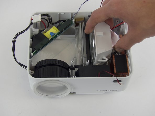

  13. DBPOWER T20 Speaker Replacement: crwdns2935265:013crwdnd2935265:01crwdnd2935265:03crwdne2935265:0 DBPOWER T20 Speaker Replacement: crwdns2935265:013crwdnd2935265:02crwdnd2935265:03crwdne2935265:0 DBPOWER T20 Speaker Replacement: crwdns2935265:013crwdnd2935265:03crwdnd2935265:03crwdne2935265:0
    • Slide out the power source and disconnect its cables from the power jack and the light.

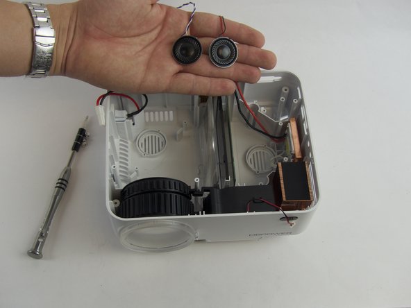

  14. DBPOWER T20 Speaker Replacement: crwdns2935265:014crwdnd2935265:01crwdnd2935265:03crwdne2935265:0 DBPOWER T20 Speaker Replacement: crwdns2935265:014crwdnd2935265:02crwdnd2935265:03crwdne2935265:0 DBPOWER T20 Speaker Replacement: crwdns2935265:014crwdnd2935265:03crwdnd2935265:03crwdne2935265:0
    • Remove the screws holding down the first speaker with a J0 screwdriver.
    • Remove the screws holding down the second speaker down.
