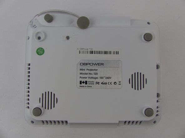

    • Flip the device and lay flat.
  2. DBPOWER T20 Lens Replacement: crwdns2935265:02crwdnd2935265:01crwdnd2935265:01crwdne2935265:0
    • Remove the four (9 mm) screws with a PH2 screwdriver.
    • Remove the two (7 mm) located with a PH2 screwdriver.
