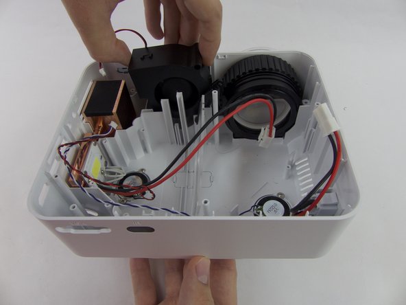

    • Raise motherboard by lifting sideways and then up to avoid the ports.
  9. DBPOWER T20 Fan Replacement: crwdns2935265:09crwdnd2935265:01crwdnd2935265:02crwdne2935265:0 DBPOWER T20 Fan Replacement: crwdns2935265:09crwdnd2935265:02crwdnd2935265:02crwdne2935265:0
    • Remove wires attaching the piezoelectric speakers to the motherboard.
  10. DBPOWER T20 Fan Replacement: crwdns2935265:010crwdnd2935265:01crwdnd2935265:02crwdne2935265:0 DBPOWER T20 Fan Replacement: crwdns2935265:010crwdnd2935265:02crwdnd2935265:02crwdne2935265:0
    • Remove the five screws securing the black plastic cover with a J0 screwdriver.
    • Lift up and out to remove.
  11. DBPOWER T20 Fan Replacement, Fan: crwdns2935265:011crwdnd2935265:01crwdnd2935265:02crwdne2935265:0 DBPOWER T20 Fan Replacement, Fan: crwdns2935265:011crwdnd2935265:02crwdnd2935265:02crwdne2935265:0
    • Pull the fan up and out of the housing.
    • In this image the lamp and power input have been removed to increase visibility, you do not have to remove these to remove the fan.
