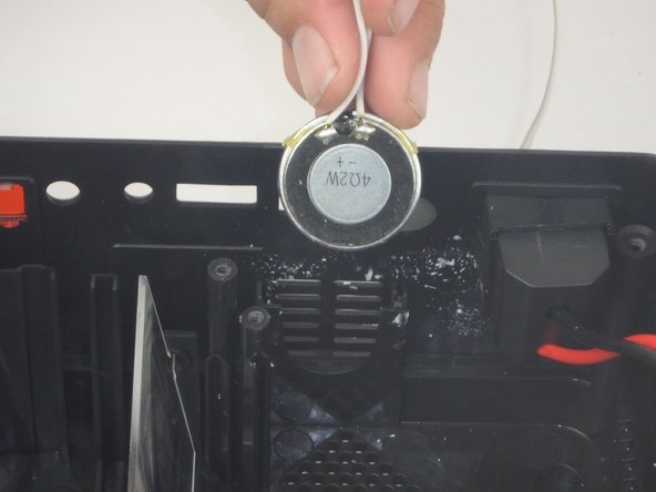

  8. DBPOWER RD-810 Speaker Replacement, Speaker: crwdns2935265:08crwdnd2935265:01crwdnd2935265:02crwdne2935265:0 DBPOWER RD-810 Speaker Replacement, Speaker: crwdns2935265:08crwdnd2935265:02crwdnd2935265:02crwdne2935265:0
    • Pull gently on the speaker to break the glue bond, then lift the speaker out of the way.
    • Do not pull on the wires while trying to break the glue bond.
