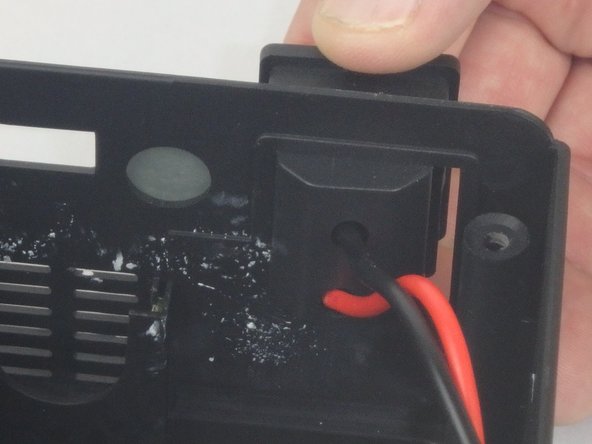

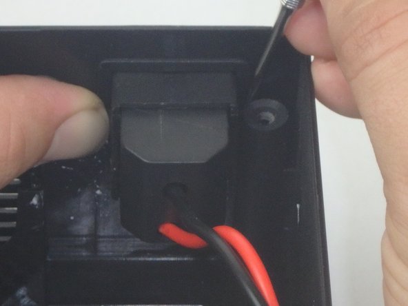

  8. DBPOWER RD-810 Power Supply Switch Replacement, Power Supply Switch: crwdns2935265:08crwdnd2935265:01crwdnd2935265:03crwdne2935265:0 DBPOWER RD-810 Power Supply Switch Replacement, Power Supply Switch: crwdns2935265:08crwdnd2935265:02crwdnd2935265:03crwdne2935265:0 DBPOWER RD-810 Power Supply Switch Replacement, Power Supply Switch: crwdns2935265:08crwdnd2935265:03crwdnd2935265:03crwdne2935265:0
    • Using the small plastic splunger, press in on the two latches on the sides of the power supply switch, then push it out of the case.
