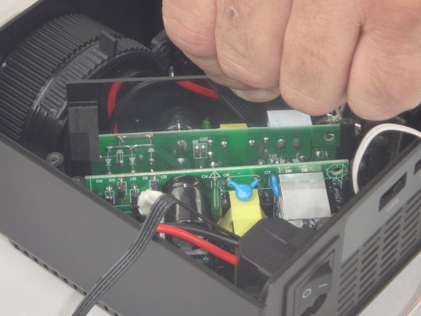

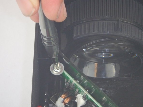

  6. DBPOWER RD-810 Power Supply Circuit Replacement, Power Supply Circuit: crwdns2935265:06crwdnd2935265:01crwdnd2935265:03crwdne2935265:0 DBPOWER RD-810 Power Supply Circuit Replacement, Power Supply Circuit: crwdns2935265:06crwdnd2935265:02crwdnd2935265:03crwdne2935265:0 DBPOWER RD-810 Power Supply Circuit Replacement, Power Supply Circuit: crwdns2935265:06crwdnd2935265:03crwdnd2935265:03crwdne2935265:0
    • Remove the two 9mm PH2 phillips head screws.
    • Lift the mirror behind the power supply circuit out to gain access to the circuit board.

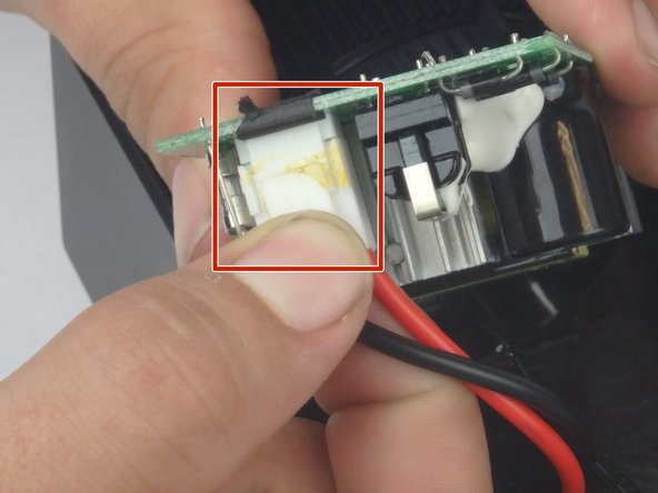

    • Lift the power supply circuit board out of the projector.
    • Disconnect the cable connector by pulling the two sides of the connector apart.
    • Keep the connector parallel to the circuit board to avoid breaking the solder connection.
