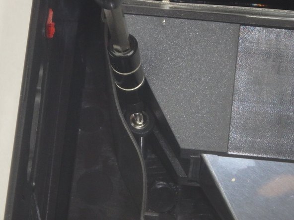

    • Make sure the projector is unplugged before starting
    • Place the projector upside down to access the screws on the bottom.
    • Remove the five 7mm long screws using a #3 Phillips screwdriver at least 2 inches long.

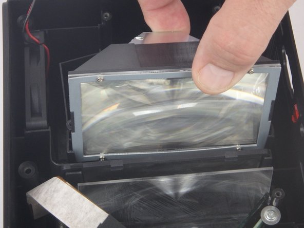

  6. DBPOWER RD-810 Magnifier Replacement, Magnifier: crwdns2935265:06crwdnd2935265:01crwdnd2935265:03crwdne2935265:0 DBPOWER RD-810 Magnifier Replacement, Magnifier: crwdns2935265:06crwdnd2935265:02crwdnd2935265:03crwdne2935265:0 DBPOWER RD-810 Magnifier Replacement, Magnifier: crwdns2935265:06crwdnd2935265:03crwdnd2935265:03crwdne2935265:0
    • Remove the two 9mm PH2 phillips head screws.
    • Lift the Magnifier out of the projector.
