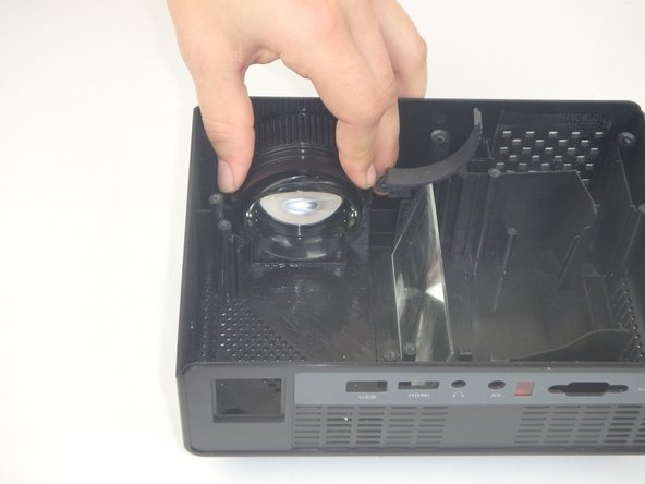

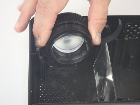

  8. DBPOWER RD-810 Lens Replacement, Lens: crwdns2935265:08crwdnd2935265:01crwdnd2935265:03crwdne2935265:0 DBPOWER RD-810 Lens Replacement, Lens: crwdns2935265:08crwdnd2935265:02crwdnd2935265:03crwdne2935265:0 DBPOWER RD-810 Lens Replacement, Lens: crwdns2935265:08crwdnd2935265:03crwdnd2935265:03crwdne2935265:0
    • Flip the projector over and remove the two 6mm PH2 phillips head screws.
    • Flip the projector over so that the opening is facing up.
    • Lift the lens up slightly and then move it towards the interior of the projector before lifting it up and out of the way.
