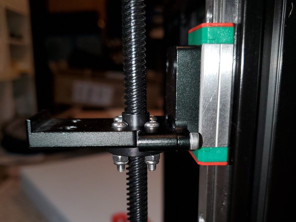

  3. D. Miscellaneous Parts, LEDs: crwdns2935265:03crwdnd2935265:01crwdnd2935265:02crwdne2935265:0 D. Miscellaneous Parts, LEDs: crwdns2935265:03crwdnd2935265:02crwdnd2935265:02crwdne2935265:0
    • As mentioned before you can mount the LEDs during the frame assembly step before you mount the Z linear rails. I chose to wait until later in the build to prevent damage.
    • It's easiest if you remove the bed and the bed frame together. Remove the 4x M5 screw holding the 2020 bed frame to the Z mounts.
    • You can choose to remove the lead screws to make it easier to gain access to the M3x8 screws mounting the Z linear rails.
    • Insert the LED strips into the LED Diffusers
    • Loosen all M3x8 screws enough to where you can slide the wire behind the linear rail so it rests in the channel.
    • Snap in the LED Diffusers.
    • Tighten the Z linear rails using the same method in Step 10 of Frame Assembly

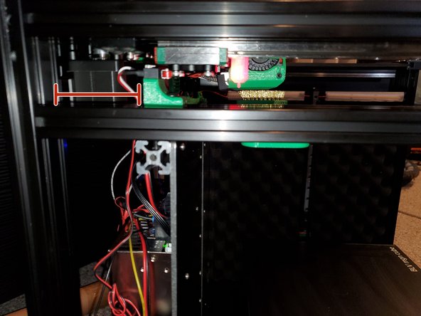

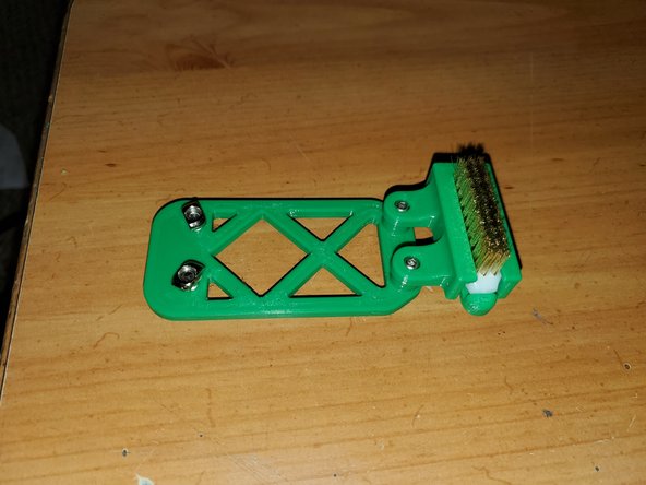

  4. D. Miscellaneous Parts, Nozzle Brush: crwdns2935265:04crwdnd2935265:01crwdnd2935265:03crwdne2935265:0 D. Miscellaneous Parts, Nozzle Brush: crwdns2935265:04crwdnd2935265:02crwdnd2935265:03crwdne2935265:0 D. Miscellaneous Parts, Nozzle Brush: crwdns2935265:04crwdnd2935265:03crwdnd2935265:03crwdne2935265:0
    • Not to be used if using a common brass nozzle. There's evidence over time the brass brush will bore out the diameter of the nozzle hole.
    • Press in 2x M3 NYLOC nuts into the bottom of the Nozzle Brush Base.
    • Thread in 2x M3x16 button head screws through the Nozzle Brush Holder into the Nozzle Brush Base.
    • Insert the brush head into the holder.

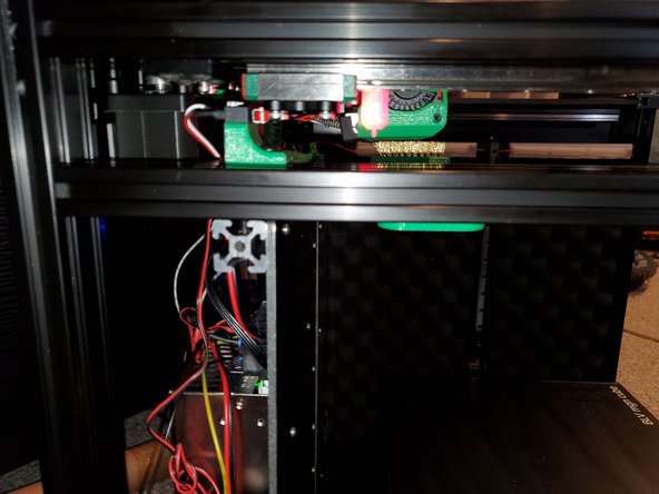

    • Mount the Nozzle Brush assembly to the frame with 2x M5x10 button head screws and 2x M5 T-nuts
    • When the nozzle is at X min and Y max the nozzle should be a few mm behind the brush. This is to ensure during the wipe movements the X mount isn't hitting the endstop
    • I modified the Brass Brush Base to suit the offsets for the metal kit. You can find the files in the FYSETC Modified Printed Parts folder on my Github

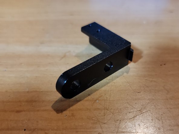

  5. D. Miscellaneous Parts, Y Endstop: crwdns2935265:05crwdnd2935265:01crwdnd2935265:03crwdne2935265:0 D. Miscellaneous Parts, Y Endstop: crwdns2935265:05crwdnd2935265:02crwdnd2935265:03crwdne2935265:0 D. Miscellaneous Parts, Y Endstop: crwdns2935265:05crwdnd2935265:03crwdnd2935265:03crwdne2935265:0
    • Make sure to remove the middle wire
    • The Y endstop mount that comes in the kit is not correct for what is provided in the kit. Use the printed replacement from FYSETC Github
    • Using 2x M2.5x8 socket head screws mount the Y Endstop to the Y Endstop mount
    • Mount the Y Endstop to the frame with 2x M5x10 button head screws and 2x M5 T-nuts
    • The Y Endstop will be 60mm from the inside of the back 2040. Basically the back of the endstop mount should be in line with the cross 576mm 2020
    • FYSETC manufactured a new Y endstop mount for the metal kit. I do not know when they started including the part in the kit.
    • To mount use 2x M3x8 button head screws and 2x M3 T-nuts. -More info to come
    • A new version of the Y endstop has been added to the kit as of August 2021
