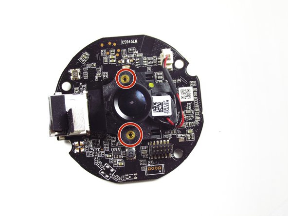

  4. D-Link HD Wi-Fi Camera Camera Lens Replacement, Camera Lens: crwdns2935265:04crwdnd2935265:01crwdnd2935265:02crwdne2935265:0 D-Link HD Wi-Fi Camera Camera Lens Replacement, Camera Lens: crwdns2935265:04crwdnd2935265:02crwdnd2935265:02crwdne2935265:0
    • Make sure your hands are dry and you are working in a dry area. To prevent damage, do not touch the lens.
    • There are two Phillips #00 6.0mm screws keeping the camera in place. Remove the screws first.
    • Gently unplug the camera from the motherboard, and remove the camera.
