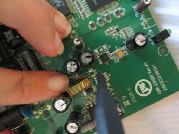

  8. D-Link EBR-2310 disassembly for cleaning, Maintain Blue Rubber Coverings: crwdns2935265:08crwdnd2935265:01crwdnd2935265:01crwdne2935265:0
    • Locate the blue rubber wire coverings near the main cable connections of your motherboard. Make sure that these are standing upright.
    • If they are not, gently use your wire tweezers to rearrange them in the correct upright position.
  9. D-Link EBR-2310 disassembly for cleaning, Wire Tube: crwdns2935265:09crwdnd2935265:01crwdnd2935265:02crwdne2935265:0 D-Link EBR-2310 disassembly for cleaning, Wire Tube: crwdns2935265:09crwdnd2935265:02crwdnd2935265:02crwdne2935265:0
    • Locate the upright wire tube towards the middle left of the motherboard.
    • Make sure that the wires are evenly spaced, not directly touching one another on the tube.
    • If the wires are not evenly spaced, gently use your spudger tool to separate them.
