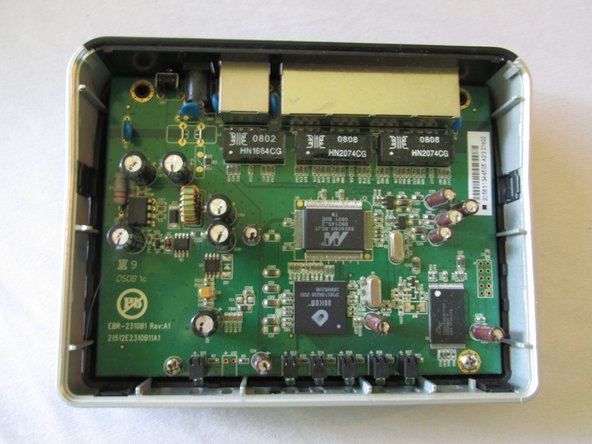

    • Once you have removed the top black case of the router, remove the silver casing surrounding the logic board.
    • It should easily snap out of place.
  5. D-Link EBR-2310 Motherboard Replacement, Remove Inner Bottom Screws: crwdns2935265:05crwdnd2935265:01crwdnd2935265:02crwdne2935265:0 D-Link EBR-2310 Motherboard Replacement, Remove Inner Bottom Screws: crwdns2935265:05crwdnd2935265:02crwdnd2935265:02crwdne2935265:0
    • Use a Phillips #2 screwdriver to remove the two screws at the bottom of the motherboard.
  6. D-Link EBR-2310 Motherboard Replacement, Remove Bottom Case: crwdns2935265:06crwdnd2935265:01crwdnd2935265:01crwdne2935265:0
    • Now that you have removed all screws and the surrounding silver casing, pop the logic board out from the bottom component of the router.
    • You have now removed the logic board from your device.
