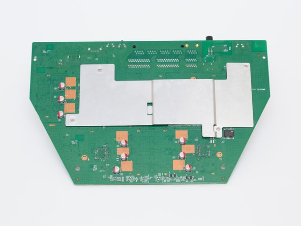

    1. D-Link DIR-890L Reset Button Replacement, Reset Button: crwdns2935265:07crwdnd2935265:01crwdnd2935265:03crwdne2935265:0 D-Link DIR-890L Reset Button Replacement, Reset Button: crwdns2935265:07crwdnd2935265:02crwdnd2935265:03crwdne2935265:0 D-Link DIR-890L Reset Button Replacement, Reset Button: crwdns2935265:07crwdnd2935265:03crwdnd2935265:03crwdne2935265:0
      • Locate the reset switch at the top of the motherboard.
      • Flip the motherboard over.
      • Locate the reset switch's 4 solder joints on the underside of the motherboard.
    2. D-Link DIR-890L Reset Button Replacement: crwdns2935265:08crwdnd2935265:01crwdnd2935265:01crwdne2935265:0
      Desoldering Pump
      $3.99
      • Using a soldering iron and desoldering pump, desolder the reset switch from the board.
      • For more information, see this guide on desoldering.
