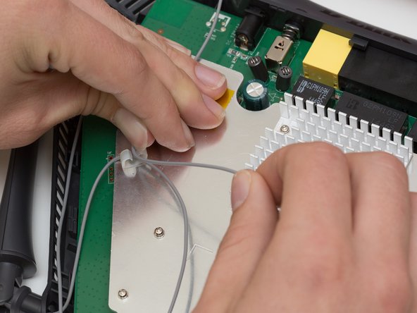

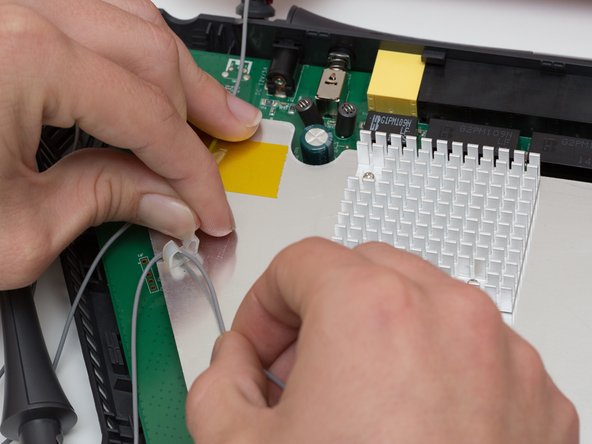

    • Continue to pry off the last three antenna connections on the upper right portion of the motherboard.
  7. D-Link DIR-890L Power Switch Replacement: crwdns2935265:07crwdnd2935265:01crwdnd2935265:03crwdne2935265:0 D-Link DIR-890L Power Switch Replacement: crwdns2935265:07crwdnd2935265:02crwdnd2935265:03crwdne2935265:0 D-Link DIR-890L Power Switch Replacement: crwdns2935265:07crwdnd2935265:03crwdnd2935265:03crwdne2935265:0
    • Open the plastic bracket enclosing the three antenna wires and pull the wires out with your hands.

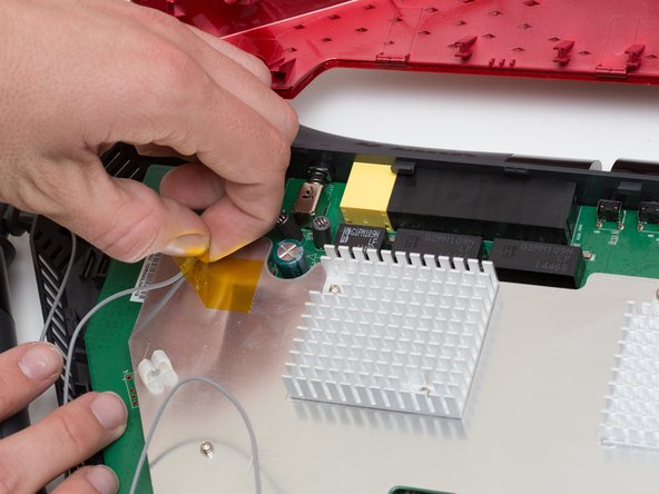

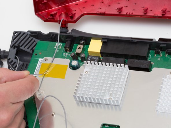

  8. D-Link DIR-890L Power Switch Replacement: crwdns2935265:08crwdnd2935265:01crwdnd2935265:03crwdne2935265:0 D-Link DIR-890L Power Switch Replacement: crwdns2935265:08crwdnd2935265:02crwdnd2935265:03crwdne2935265:0 D-Link DIR-890L Power Switch Replacement: crwdns2935265:08crwdnd2935265:03crwdnd2935265:03crwdne2935265:0
    • Pull the yellow tape off of the motherboard to release the final antenna wire.

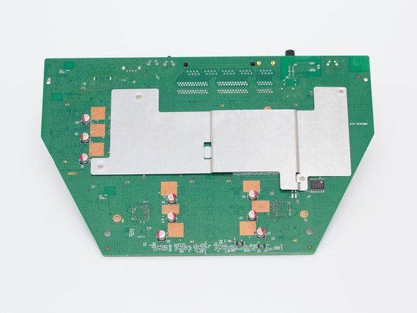

  9. D-Link DIR-890L Power Switch Replacement: crwdns2935265:09crwdnd2935265:01crwdnd2935265:02crwdne2935265:0 D-Link DIR-890L Power Switch Replacement: crwdns2935265:09crwdnd2935265:02crwdnd2935265:02crwdne2935265:0
    • Pull the the motherboard away from the case to remove it. Start on the side closest to you, and pull up and out.

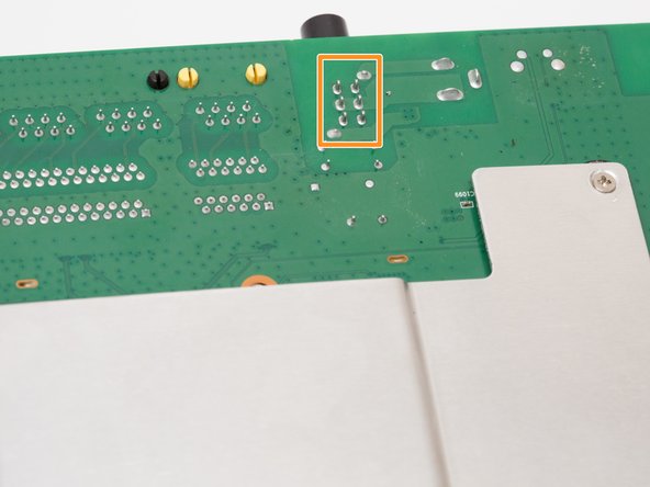

  10. D-Link DIR-890L Power Switch Replacement, Power Switch: crwdns2935265:010crwdnd2935265:01crwdnd2935265:03crwdne2935265:0 D-Link DIR-890L Power Switch Replacement, Power Switch: crwdns2935265:010crwdnd2935265:02crwdnd2935265:03crwdne2935265:0 D-Link DIR-890L Power Switch Replacement, Power Switch: crwdns2935265:010crwdnd2935265:03crwdnd2935265:03crwdne2935265:0
    • Locate the power switch on the top left of the motherboard.
    • The power switch is the component that sticks out the furthest.
    • Turn the motherboard upside down.
    • Locate the 6 solder joints that connect the power switch to the motherboard. They are arranged in 2 columns of 3.

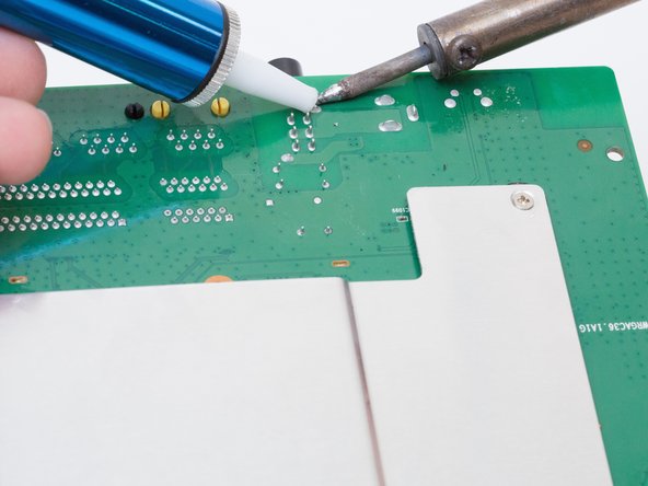

  11. D-Link DIR-890L Power Switch Replacement: crwdns2935265:011crwdnd2935265:01crwdnd2935265:02crwdne2935265:0 D-Link DIR-890L Power Switch Replacement: crwdns2935265:011crwdnd2935265:02crwdnd2935265:02crwdne2935265:0
    Desoldering Pump
    $3.99
    • Using a soldering iron and desoldering pump, desolder the power switch from the board.
    • For more information, see this guide on desoldering.
