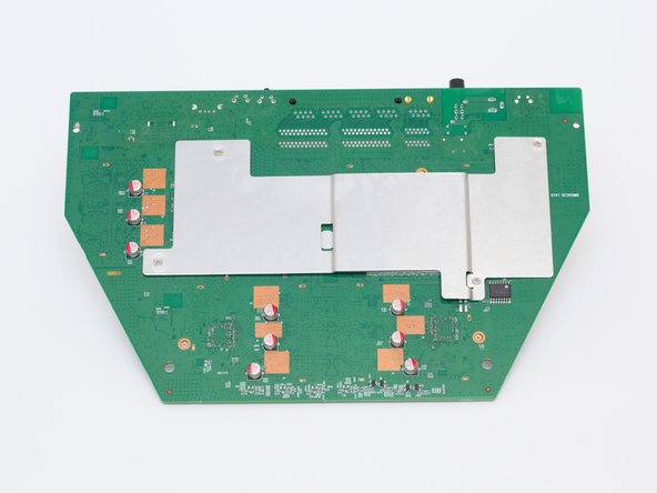

      • Pull the the motherboard away from the case to remove it. Start on the side closest to you, and pull up and out.

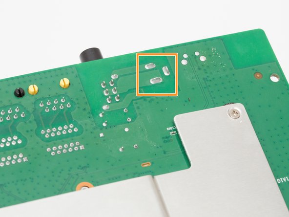

    1. D-Link DIR-890L Power Adapter Port Replacement, Power Adapter Port: crwdns2935265:010crwdnd2935265:01crwdnd2935265:03crwdne2935265:0 D-Link DIR-890L Power Adapter Port Replacement, Power Adapter Port: crwdns2935265:010crwdnd2935265:02crwdnd2935265:03crwdne2935265:0 D-Link DIR-890L Power Adapter Port Replacement, Power Adapter Port: crwdns2935265:010crwdnd2935265:03crwdnd2935265:03crwdne2935265:0
      • Locate the power adapter port at the top left of the motherboard.
      • Flip the motherboard over.
      • Locate the 3 solder joints that connect the power adapter port to the motherboard.

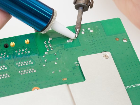

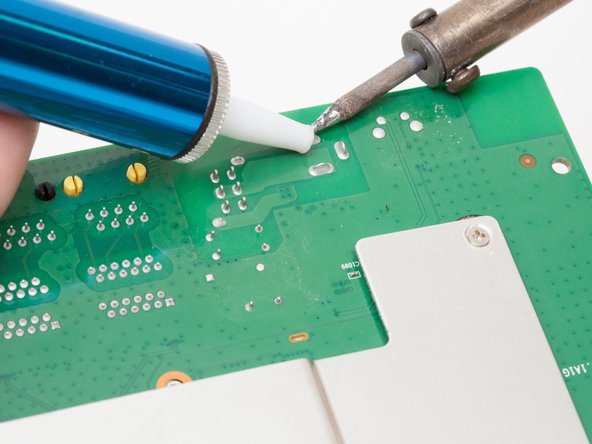

    2. D-Link DIR-890L Power Adapter Port Replacement: crwdns2935265:011crwdnd2935265:01crwdnd2935265:03crwdne2935265:0 D-Link DIR-890L Power Adapter Port Replacement: crwdns2935265:011crwdnd2935265:02crwdnd2935265:03crwdne2935265:0 D-Link DIR-890L Power Adapter Port Replacement: crwdns2935265:011crwdnd2935265:03crwdnd2935265:03crwdne2935265:0
      Desoldering Pump
      $3.99
      • Using a soldering iron and desoldering pump, desolder the power adapter port from the board.
      • For more information, see this guide on desoldering
