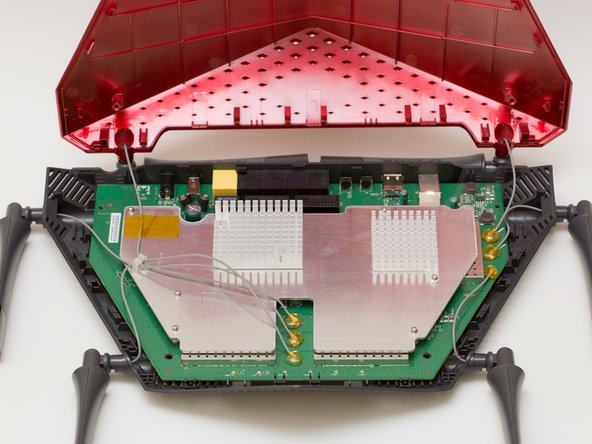

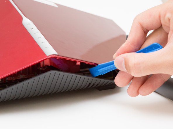

    3. D-Link DIR-890L Heat Sink Replacement: crwdns2935265:03crwdnd2935265:01crwdnd2935265:03crwdne2935265:0 D-Link DIR-890L Heat Sink Replacement: crwdns2935265:03crwdnd2935265:02crwdnd2935265:03crwdne2935265:0 D-Link DIR-890L Heat Sink Replacement: crwdns2935265:03crwdnd2935265:03crwdnd2935265:03crwdne2935265:0
      • Wedge the opening tool between the red top panel and the gray bottom panel.
      • Twist the opening tool to separate the panels. Work your way around the case until both of the panels are separated.

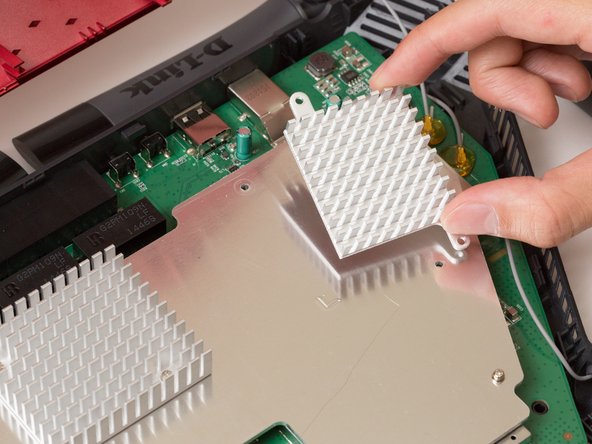

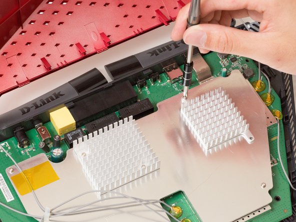

    1. D-Link DIR-890L Heat Sink Replacement, Heat Sink: crwdns2935265:04crwdnd2935265:01crwdnd2935265:03crwdne2935265:0 D-Link DIR-890L Heat Sink Replacement, Heat Sink: crwdns2935265:04crwdnd2935265:02crwdnd2935265:03crwdne2935265:0 D-Link DIR-890L Heat Sink Replacement, Heat Sink: crwdns2935265:04crwdnd2935265:03crwdnd2935265:03crwdne2935265:0
      • Unscrew the two 7mm screws with a Phillips #1 screwdriver.
      • Lift the heat sink off the metal plate with your fingers.
