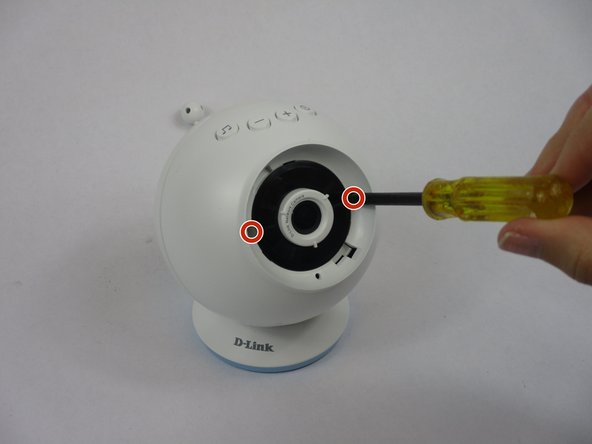

  4. D-Link DCS-825L LED Light Cover Replacement, Back Casing: crwdns2935265:04crwdnd2935265:01crwdnd2935265:02crwdne2935265:0 D-Link DCS-825L LED Light Cover Replacement, Back Casing: crwdns2935265:04crwdnd2935265:02crwdnd2935265:02crwdne2935265:0
    • Remove one Phillips #2 screw from each side of the camera lens.

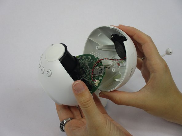

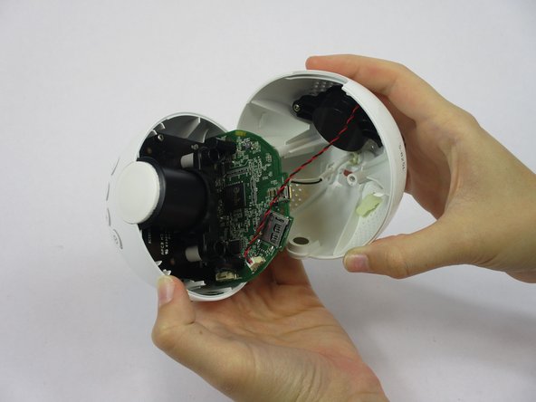

  5. D-Link DCS-825L LED Light Cover Replacement: crwdns2935265:05crwdnd2935265:01crwdnd2935265:03crwdne2935265:0 D-Link DCS-825L LED Light Cover Replacement: crwdns2935265:05crwdnd2935265:02crwdnd2935265:03crwdne2935265:0 D-Link DCS-825L LED Light Cover Replacement: crwdns2935265:05crwdnd2935265:03crwdnd2935265:03crwdne2935265:0
    • Pull the Wi-Fi Baby Camera open.
    • It should be easily done after the screws are removed.

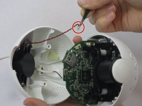

  6. D-Link DCS-825L LED Light Cover Replacement: crwdns2935265:06crwdnd2935265:01crwdnd2935265:02crwdne2935265:0 D-Link DCS-825L LED Light Cover Replacement: crwdns2935265:06crwdnd2935265:02crwdnd2935265:02crwdne2935265:0
    • Take your tweezers and gently pull the white tip out from its plug that is connected to a red and black twisted wire.

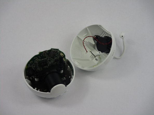

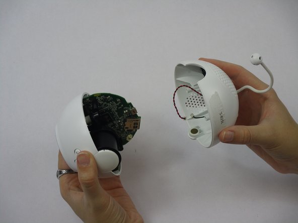

  7. D-Link DCS-825L LED Light Cover Replacement: crwdns2935265:07crwdnd2935265:01crwdnd2935265:03crwdne2935265:0 D-Link DCS-825L LED Light Cover Replacement: crwdns2935265:07crwdnd2935265:02crwdnd2935265:03crwdne2935265:0 D-Link DCS-825L LED Light Cover Replacement: crwdns2935265:07crwdnd2935265:03crwdnd2935265:03crwdne2935265:0
    • Take your tweezers and gently pull the white tip that is on the end of the white wire (the antenna) out from its plug in.
