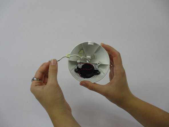

  8. D-Link DCS-825L Antenna Replacement, Antenna: crwdns2935265:08crwdnd2935265:01crwdnd2935265:01crwdne2935265:0
    • Once you have the back casing removed from the other half of the device, it should look like this with the antenna poking out.

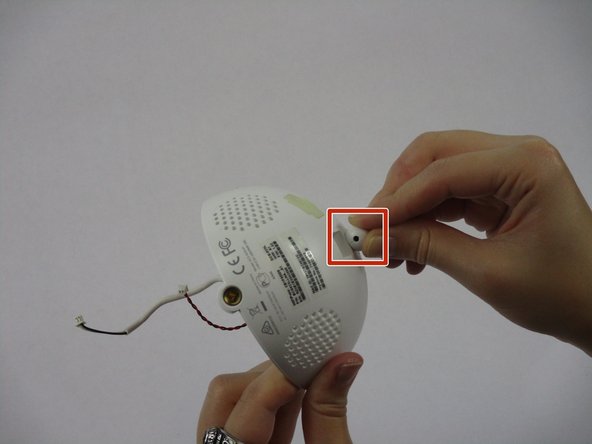

  9. D-Link DCS-825L Antenna Replacement: crwdns2935265:09crwdnd2935265:01crwdnd2935265:03crwdne2935265:0 D-Link DCS-825L Antenna Replacement: crwdns2935265:09crwdnd2935265:02crwdnd2935265:03crwdne2935265:0 D-Link DCS-825L Antenna Replacement: crwdns2935265:09crwdnd2935265:03crwdnd2935265:03crwdne2935265:0
    • There will be a light yellow rubber stopper that is holding the antenna in place.
    • With your tweezers, gently tug on the stopper to make it come out, or at least come loose.
    • If the stopper does not completely come out, use the round top of the antenna to push down on it.
    • You can do this simply by pulling the antenna as close to the back casing as possible, and then pushing down on it until the rubber stopper comes out completely.
    • After it has come out, it can either be taken off from the antenna and set aside, or it can be kept on.

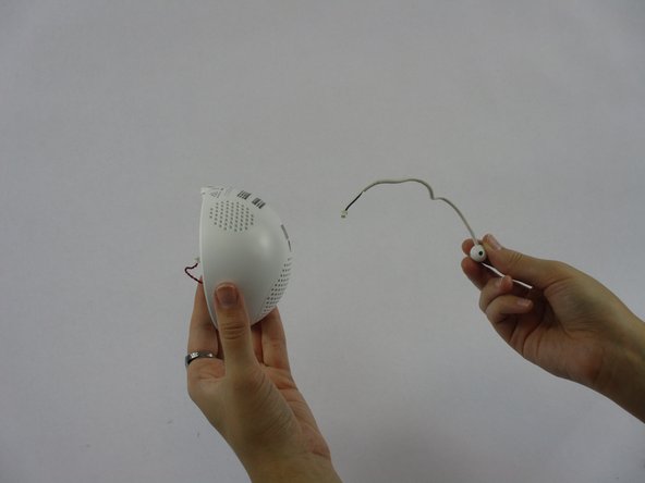

  10. D-Link DCS-825L Antenna Replacement: crwdns2935265:010crwdnd2935265:01crwdnd2935265:02crwdne2935265:0 D-Link DCS-825L Antenna Replacement: crwdns2935265:010crwdnd2935265:02crwdnd2935265:02crwdne2935265:0
    • Once the rubber stopper has been pushed out, you will now be able to easily pull the antenna out from the back casing.
    • After it has been removed, you are now able to replace the antenna of your Wi-Fi Baby Camera.
