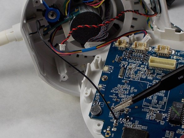

  3. D-Link DCS-5222L WiFi Antenna Replacement: crwdns2935265:03crwdnd2935265:01crwdnd2935265:02crwdne2935265:0 D-Link DCS-5222L WiFi Antenna Replacement: crwdns2935265:03crwdnd2935265:02crwdnd2935265:02crwdne2935265:0
    • Using your hands, open the camera body by wiggling the bottom free from the upper shell.
    • Open the shell carefully, as the motherboard is attached to the bottom of the body; all of the components in the upper body are accordingly connected to the bottom. Likewise, the WiFi antenna is mounted to the upper shell, but a wire connects it to the motherboard on the bottom of the body.

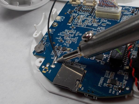

  4. D-Link DCS-5222L WiFi Antenna Replacement: crwdns2935265:04crwdnd2935265:01crwdnd2935265:02crwdne2935265:0 D-Link DCS-5222L WiFi Antenna Replacement: crwdns2935265:04crwdnd2935265:02crwdnd2935265:02crwdne2935265:0
    • Using your soldering iron, heat the antenna contacts on the motherboard until the wire releases.
    • Soldering Irons are hot and can burn you and ignite flammable materials.

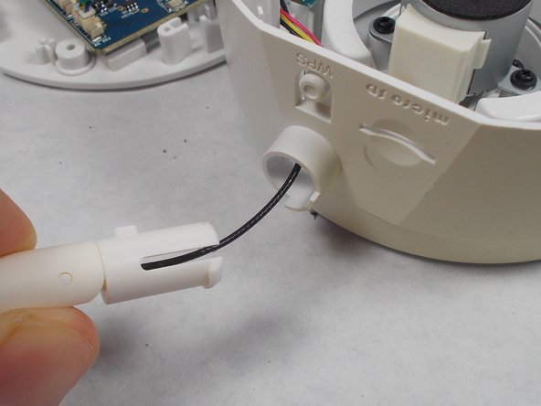

  5. D-Link DCS-5222L WiFi Antenna Replacement: crwdns2935265:05crwdnd2935265:01crwdnd2935265:02crwdne2935265:0 D-Link DCS-5222L WiFi Antenna Replacement: crwdns2935265:05crwdnd2935265:02crwdnd2935265:02crwdne2935265:0
    • Pinch the WiFi antenna's clip mount inside the upper part of the body with blunt ended tweezers while pulling the antenna from the outside.
