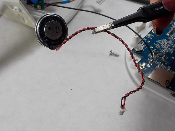

    • Remove the four rubber pieces to gain access to the screws.
    • Remove the four 7mm screws with a #1 Phillips screwdriver.
    • Remove the bottom of the camera body.
  2. D-Link DCS-5222L Speaker Replacement: crwdns2935265:02crwdnd2935265:01crwdnd2935265:02crwdne2935265:0 D-Link DCS-5222L Speaker Replacement: crwdns2935265:02crwdnd2935265:02crwdnd2935265:02crwdne2935265:0
    • Using safety tweezers, disconnect the 2-wire connector with the red and black leads located close to the ethernet and SD ports.
    • Disconnect the cables gently.
  3. D-Link DCS-5222L Speaker Replacement: crwdns2935265:03crwdnd2935265:01crwdnd2935265:02crwdne2935265:0 D-Link DCS-5222L Speaker Replacement: crwdns2935265:03crwdnd2935265:02crwdnd2935265:02crwdne2935265:0
    • The speaker is circular, black and silver in color with a red and black cord. It is easily removed from the upper body of the camera with your fingers or safety tweezers.
