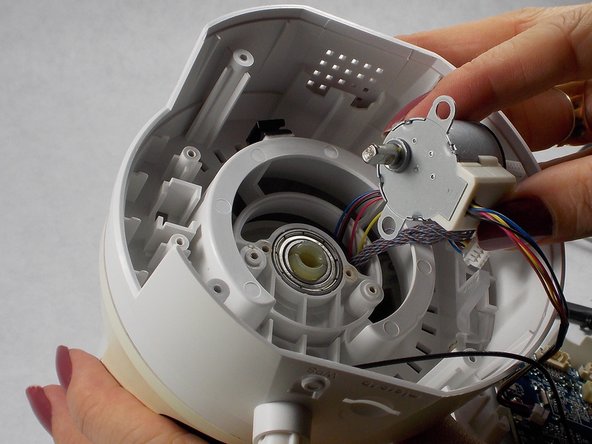

  3. D-Link DCS-5222L Motor Replacement: crwdns2935265:03crwdnd2935265:01crwdnd2935265:02crwdne2935265:0 D-Link DCS-5222L Motor Replacement: crwdns2935265:03crwdnd2935265:02crwdnd2935265:02crwdne2935265:0
    • Use a #1 Phillips screwdriver to remove the two 7mm screws holding the motor in place.

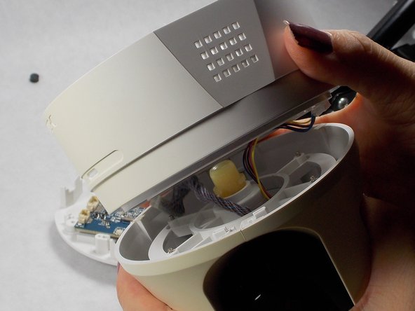

  4. D-Link DCS-5222L Motor Replacement: crwdns2935265:04crwdnd2935265:01crwdnd2935265:02crwdne2935265:0 D-Link DCS-5222L Motor Replacement: crwdns2935265:04crwdnd2935265:02crwdnd2935265:02crwdne2935265:0
    • Using your hands, separate the bottom of the body from the upper portion.

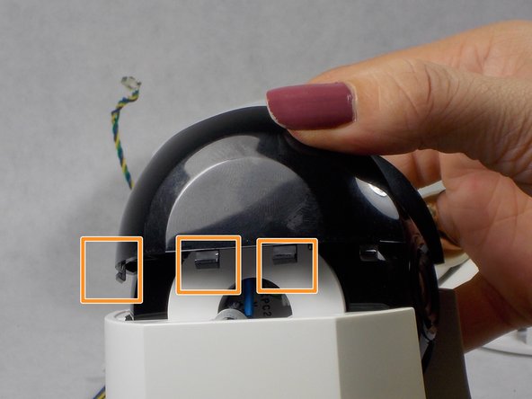

  5. D-Link DCS-5222L Motor Replacement: crwdns2935265:05crwdnd2935265:01crwdnd2935265:02crwdne2935265:0 D-Link DCS-5222L Motor Replacement: crwdns2935265:05crwdnd2935265:02crwdnd2935265:02crwdne2935265:0
    • To remove the top of the camera you must push in the black tabs using the spudger. There are 3 tabs per side.
    • While pushing in the tabs, you can now lift the top black portion of the camera using your hands.

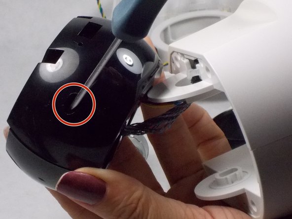

  6. D-Link DCS-5222L Motor Replacement: crwdns2935265:06crwdnd2935265:01crwdnd2935265:02crwdne2935265:0 D-Link DCS-5222L Motor Replacement: crwdns2935265:06crwdnd2935265:02crwdnd2935265:02crwdne2935265:0
    • With a little wiggle, the camera module will come free from the body.
    • Unscrew the two 7mm screws on the camera using a #1 Phillips screwdriver.

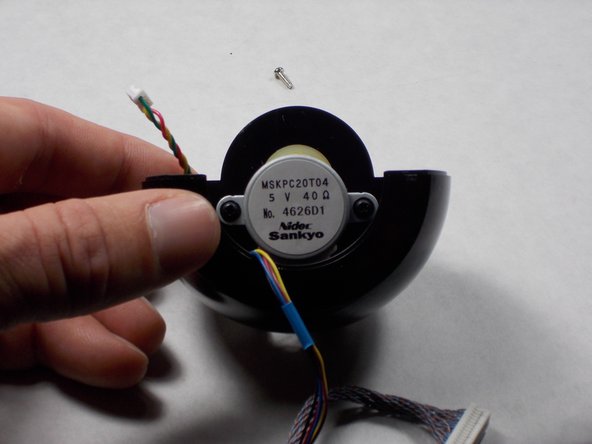

  8. D-Link DCS-5222L Motor Replacement: crwdns2935265:08crwdnd2935265:01crwdnd2935265:01crwdne2935265:0
    • Unscrew the two 6mm screws holding the motor in place with a #1 Phillips screwdriver.
