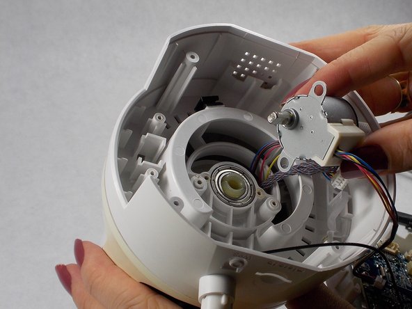

  3. D-Link DCS-5222L Lens Replacement: crwdns2935265:03crwdnd2935265:01crwdnd2935265:03crwdne2935265:0 D-Link DCS-5222L Lens Replacement: crwdns2935265:03crwdnd2935265:02crwdnd2935265:03crwdne2935265:0 D-Link DCS-5222L Lens Replacement: crwdns2935265:03crwdnd2935265:03crwdnd2935265:03crwdne2935265:0
    • Remove the two 7mm screws holding the motor using a #1 Phillips screwdriver.
    • Pull off the motor and lift away the midbody of the camera using your hands.

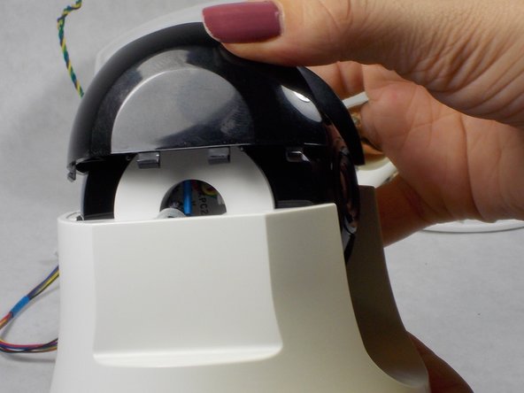

  4. D-Link DCS-5222L Lens Replacement: crwdns2935265:04crwdnd2935265:01crwdnd2935265:02crwdne2935265:0 D-Link DCS-5222L Lens Replacement: crwdns2935265:04crwdnd2935265:02crwdnd2935265:02crwdne2935265:0
    • Separate the black camera shroud from the upper body by prying loose the tabs with a plastic opening tool or spudger.
    • Use your hands to wiggle the shroud free.

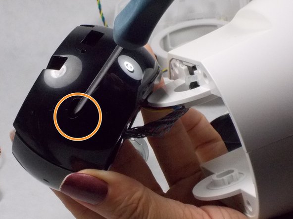

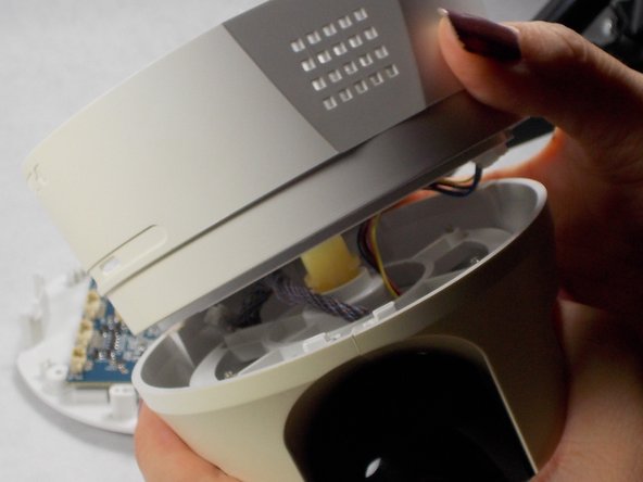

  5. D-Link DCS-5222L Lens Replacement: crwdns2935265:05crwdnd2935265:01crwdnd2935265:03crwdne2935265:0 D-Link DCS-5222L Lens Replacement: crwdns2935265:05crwdnd2935265:02crwdnd2935265:03crwdne2935265:0 D-Link DCS-5222L Lens Replacement: crwdns2935265:05crwdnd2935265:03crwdnd2935265:03crwdne2935265:0
    • Use a #1 Phillips screwdriver to unscrew the four 5mm screws on both sides of the black camera housing to separate it from white body.
    • Unscrew the two 7mm #1 Phillips screws on both sides of the camera housing to open it.

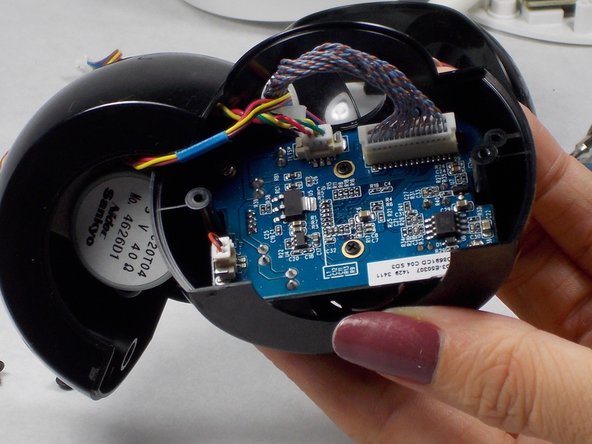

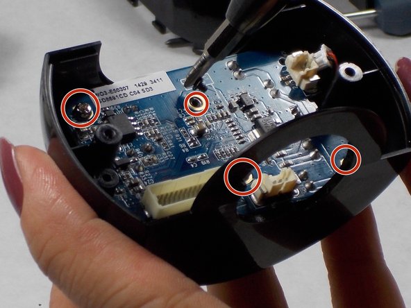

  6. D-Link DCS-5222L Lens Replacement: crwdns2935265:06crwdnd2935265:01crwdnd2935265:03crwdne2935265:0 D-Link DCS-5222L Lens Replacement: crwdns2935265:06crwdnd2935265:02crwdnd2935265:03crwdne2935265:0 D-Link DCS-5222L Lens Replacement: crwdns2935265:06crwdnd2935265:03crwdnd2935265:03crwdne2935265:0
    • Gently disconnect the three cables from the small motherboard using safety tweezers.
    • Use a #0 Phillips screwdriver to remove the two black 2mm screws and a #1 Phillips screwdriver to remove the 2 silver 6mm screws.
    • Separate the board from the black housing.

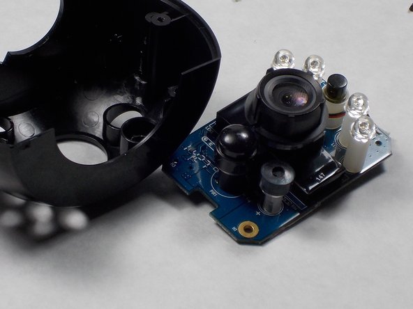

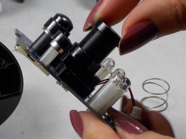

  7. D-Link DCS-5222L Lens Replacement: crwdns2935265:07crwdnd2935265:01crwdnd2935265:03crwdne2935265:0 D-Link DCS-5222L Lens Replacement: crwdns2935265:07crwdnd2935265:02crwdnd2935265:03crwdne2935265:0 D-Link DCS-5222L Lens Replacement: crwdns2935265:07crwdnd2935265:03crwdnd2935265:03crwdne2935265:0

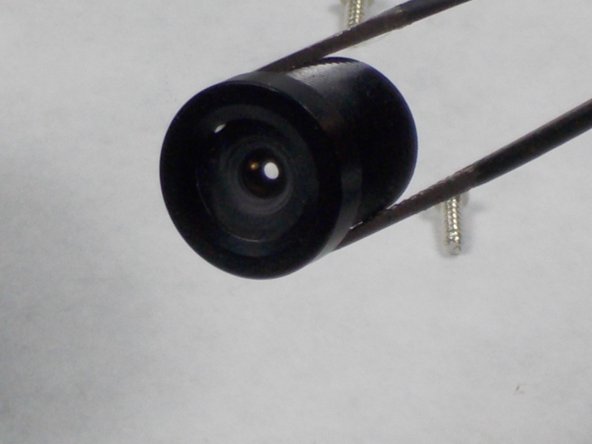

    • Using your fingers, remove the focus adjustment ring.
    • Twist the lens to unscrew it from the camera module.
    • Replace the broken lens with new one and reassemble all parts of the camera respectively.
