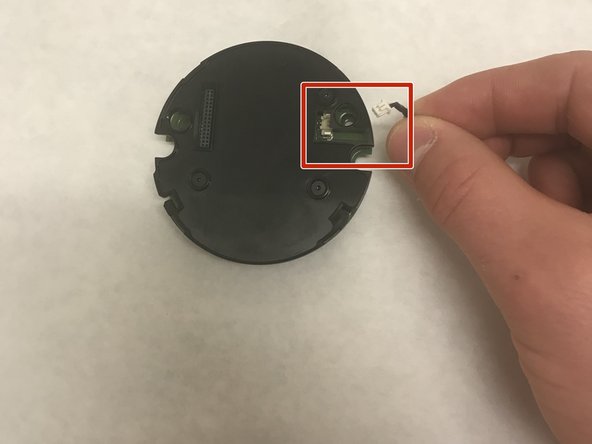

    • Remove the two 9.65 mm screws on the back cover using the Philips head PH00 screw driver.
  2. D-Link DCS-2630L Wi-Fi Camera Microphone Replacement: crwdns2935265:02crwdnd2935265:01crwdnd2935265:01crwdne2935265:0
    • Remove the back casing to expose the circuit board.

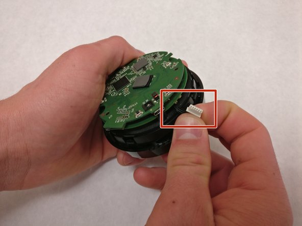

  6. D-Link DCS-2630L Wi-Fi Camera Microphone Replacement: crwdns2935265:06crwdnd2935265:01crwdnd2935265:02crwdne2935265:0 D-Link DCS-2630L Wi-Fi Camera Microphone Replacement: crwdns2935265:06crwdnd2935265:02crwdnd2935265:02crwdne2935265:0
    • Detach the white plug by gently pulling on the black wires.

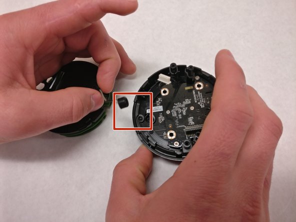

  7. D-Link DCS-2630L Wi-Fi Camera Microphone Replacement: crwdns2935265:07crwdnd2935265:01crwdnd2935265:02crwdne2935265:0 D-Link DCS-2630L Wi-Fi Camera Microphone Replacement: crwdns2935265:07crwdnd2935265:02crwdnd2935265:02crwdne2935265:0
    • Remove the circuit board to expose the camera body.
    • At the same time, you will need to feed the wires through the circuit board and out the slot in the black plate under the circuit board.

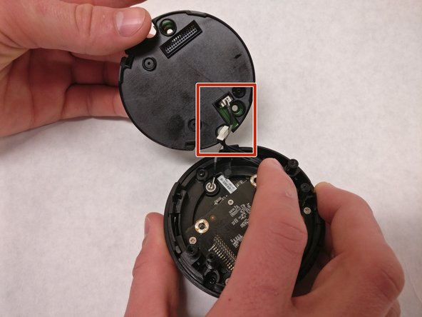

  8. D-Link DCS-2630L Wi-Fi Camera Microphone Replacement: crwdns2935265:08crwdnd2935265:01crwdnd2935265:02crwdne2935265:0 D-Link DCS-2630L Wi-Fi Camera Microphone Replacement: crwdns2935265:08crwdnd2935265:02crwdnd2935265:02crwdne2935265:0

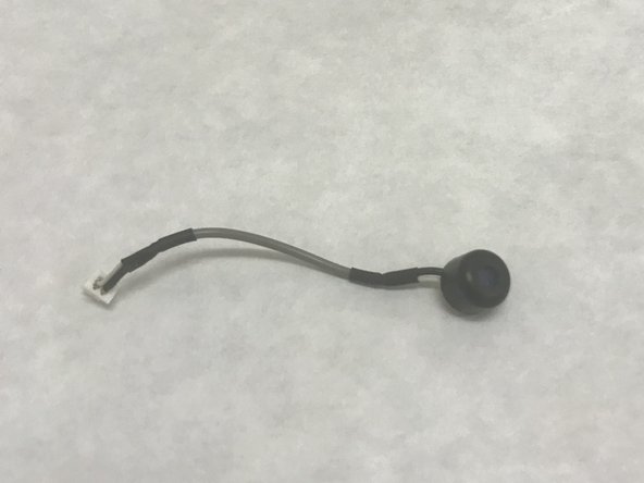

    • Gently pull on the grey wire to detach the microphone from the camera body.
  9. D-Link DCS-2630L Wi-Fi Camera Microphone Replacement: crwdns2935265:09crwdnd2935265:01crwdnd2935265:03crwdne2935265:0 D-Link DCS-2630L Wi-Fi Camera Microphone Replacement: crwdns2935265:09crwdnd2935265:02crwdnd2935265:03crwdne2935265:0 D-Link DCS-2630L Wi-Fi Camera Microphone Replacement: crwdns2935265:09crwdnd2935265:03crwdnd2935265:03crwdne2935265:0
    • Detach the microphone from the circuit board by gently pulling on the grey wire.
