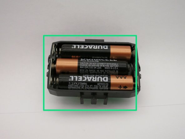

  2. Cyclops Helios Teardown: crwdns2935265:02crwdnd2935265:01crwdnd2935265:03crwdne2935265:0 Cyclops Helios Teardown: crwdns2935265:02crwdnd2935265:02crwdnd2935265:03crwdne2935265:0 Cyclops Helios Teardown: crwdns2935265:02crwdnd2935265:03crwdnd2935265:03crwdne2935265:0
    • Using two hands, carefully separate the front panel and back panel of the Cyclops Helios.
    • Front panel - boxed in red
    • Back panel - boxed in blue

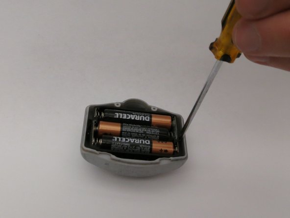

  3. Cyclops Helios Teardown: crwdns2935265:03crwdnd2935265:01crwdnd2935265:02crwdne2935265:0 Cyclops Helios Teardown: crwdns2935265:03crwdnd2935265:02crwdnd2935265:02crwdne2935265:0
    • Use a Phillips head screwdriver to remove two screws from the front panel.
    • The two screws fasten the outer enclosure with the inner electronics of the front panel.

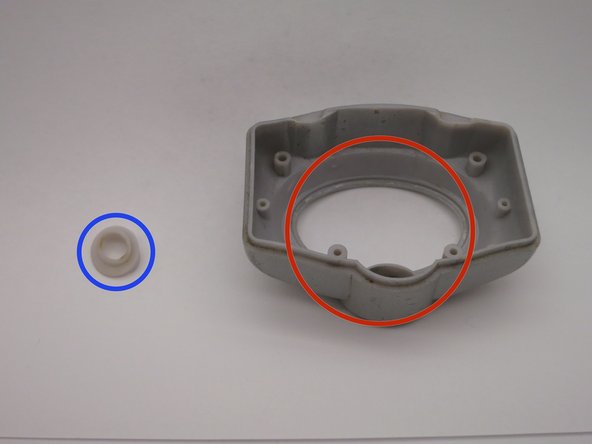

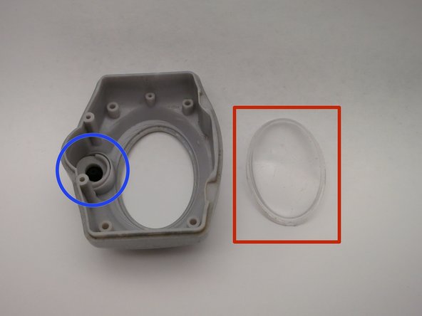

  4. Cyclops Helios Teardown: crwdns2935265:04crwdnd2935265:01crwdnd2935265:03crwdne2935265:0 Cyclops Helios Teardown: crwdns2935265:04crwdnd2935265:02crwdnd2935265:03crwdne2935265:0 Cyclops Helios Teardown: crwdns2935265:04crwdnd2935265:03crwdnd2935265:03crwdne2935265:0
    • Within the enclosure of the front panel there is a clear plastic lens, and plastic button insert. Both are removable.
    • Clear plastic lens - boxed in red
    • Plastic button insert - circled in blue

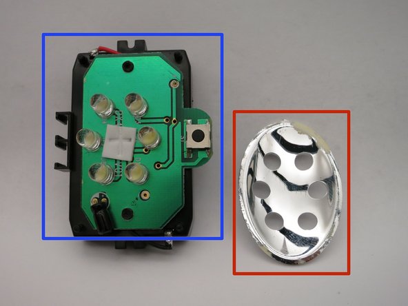

  5. Cyclops Helios Teardown: crwdns2935265:05crwdnd2935265:01crwdnd2935265:03crwdne2935265:0 Cyclops Helios Teardown: crwdns2935265:05crwdnd2935265:02crwdnd2935265:03crwdne2935265:0 Cyclops Helios Teardown: crwdns2935265:05crwdnd2935265:03crwdnd2935265:03crwdne2935265:0
    • The inner electronics of module of the front panel includes a parabolic mirror, circuit board, and battery holder.
    • Circuit board - boxed in blue
    • Parabolic mirror - boxed in red
    • Battery holder - boxed in green

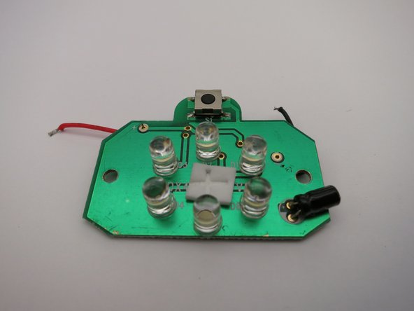

  6. Cyclops Helios Teardown: crwdns2935265:06crwdnd2935265:01crwdnd2935265:02crwdne2935265:0 Cyclops Helios Teardown: crwdns2935265:06crwdnd2935265:02crwdnd2935265:02crwdne2935265:0
    • Separate the circuit board from the battery holder by desoldering the black and red wires from the battery holder.
