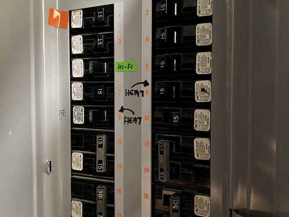

    • To avoid unforeseen electric shocks, turn off the fuse supplying power to your range hood to avoid the risk of electrocution.

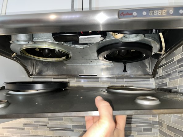

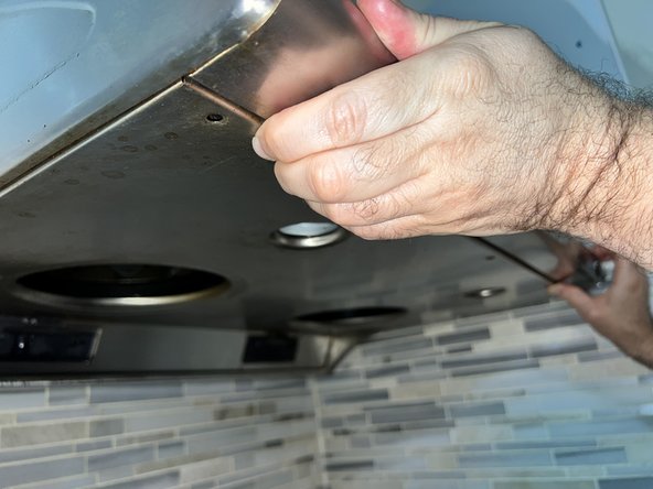

  2. Cyclone Range Hood (Model CY3000R) Circuit Board Replacement: crwdns2935265:02crwdnd2935265:01crwdnd2935265:02crwdne2935265:0 Cyclone Range Hood (Model CY3000R) Circuit Board Replacement: crwdns2935265:02crwdnd2935265:02crwdnd2935265:02crwdne2935265:0
    • The panel will be loose after the screws and bulbs are removed; be sure to support the panel while removing the screws and bulbs.

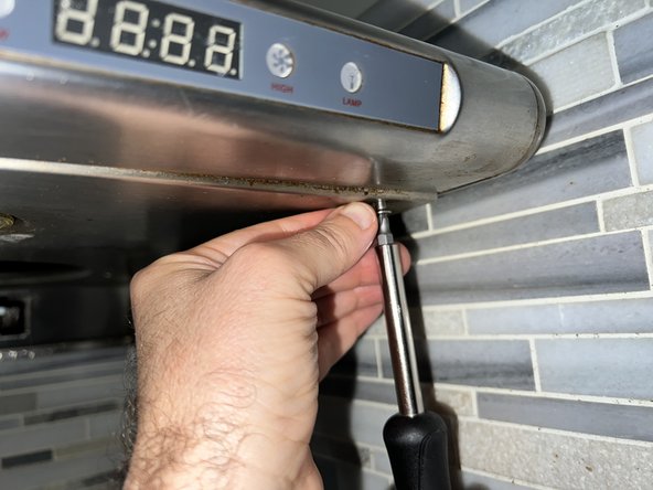

    • Remove the five 10 mm Phillips #1 screws securing the panel while holding the panel in place.

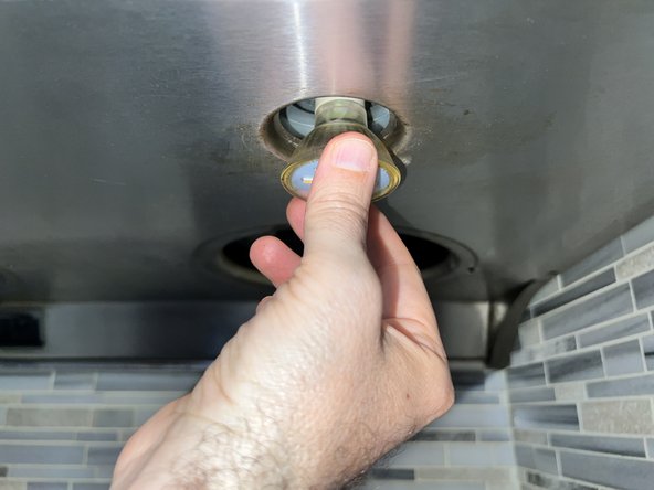

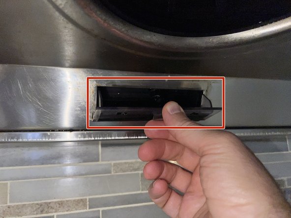

  3. Cyclone Range Hood (Model CY3000R) Circuit Board Replacement: crwdns2935265:03crwdnd2935265:01crwdnd2935265:02crwdne2935265:0 Cyclone Range Hood (Model CY3000R) Circuit Board Replacement: crwdns2935265:03crwdnd2935265:02crwdnd2935265:02crwdne2935265:0
    • Turn the LED bulbs counterclockwise and remove them.
    • Push the panel down to remove it from the body.

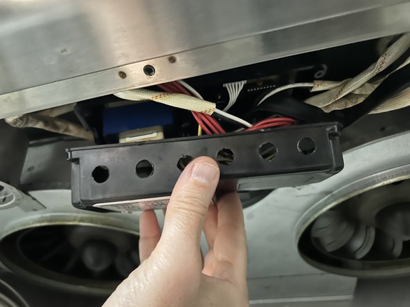

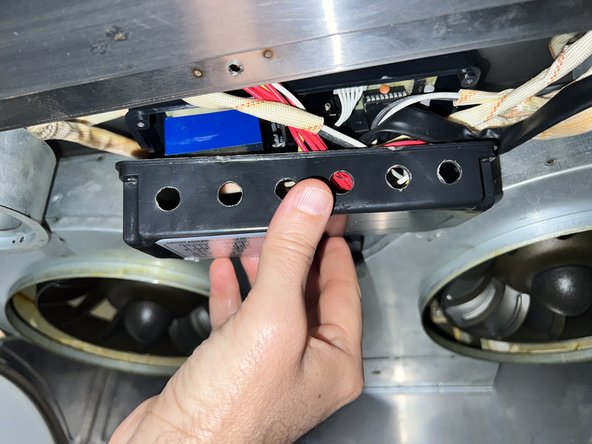

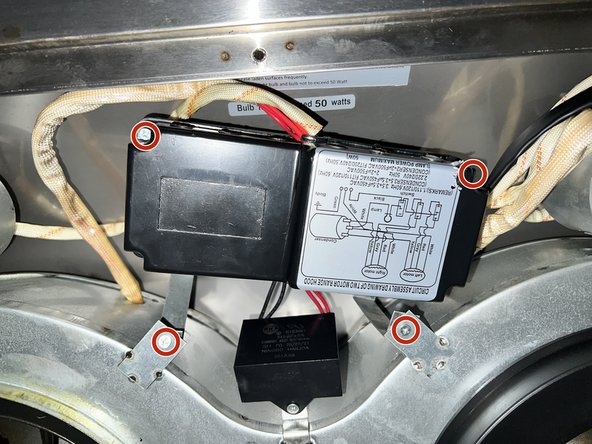

  4. Cyclone Range Hood (Model CY3000R) Circuit Board Replacement: crwdns2935265:04crwdnd2935265:01crwdnd2935265:03crwdne2935265:0 Cyclone Range Hood (Model CY3000R) Circuit Board Replacement: crwdns2935265:04crwdnd2935265:02crwdnd2935265:03crwdne2935265:0 Cyclone Range Hood (Model CY3000R) Circuit Board Replacement: crwdns2935265:04crwdnd2935265:03crwdnd2935265:03crwdne2935265:0

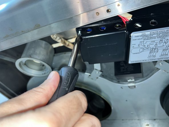

    • Carefully remove the four 5 mm Phillips #1 screws from the board box.
    • Open the lid.

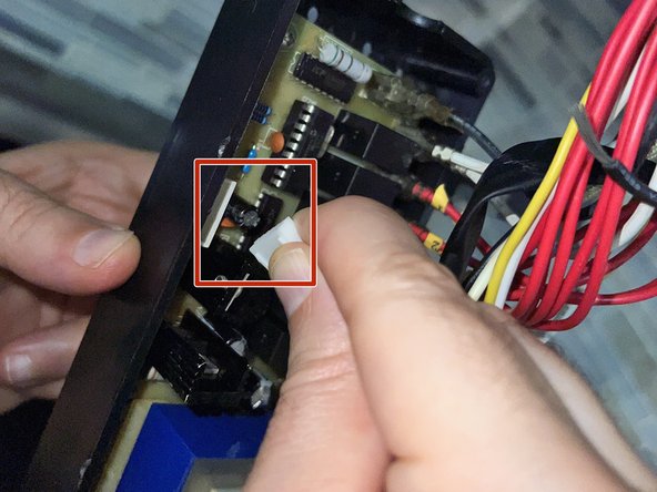

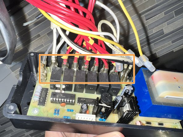

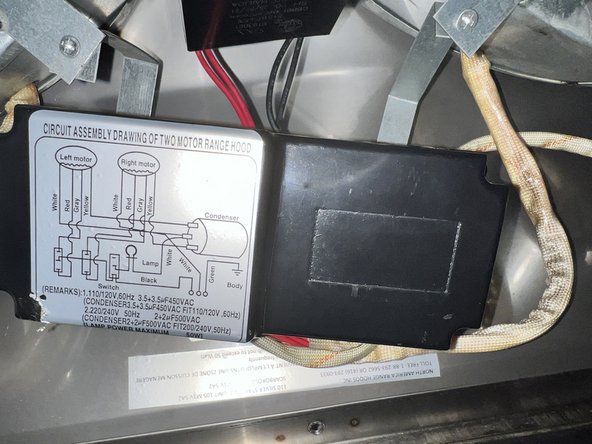

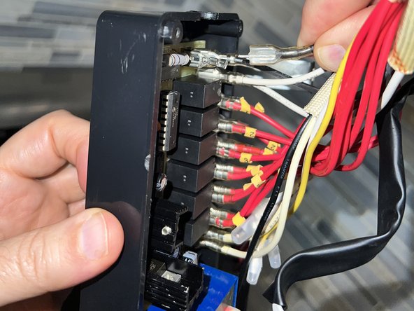

  5. Cyclone Range Hood (Model CY3000R) Circuit Board Replacement: crwdns2935265:05crwdnd2935265:01crwdnd2935265:03crwdne2935265:0 Cyclone Range Hood (Model CY3000R) Circuit Board Replacement: crwdns2935265:05crwdnd2935265:02crwdnd2935265:03crwdne2935265:0 Cyclone Range Hood (Model CY3000R) Circuit Board Replacement: crwdns2935265:05crwdnd2935265:03crwdnd2935265:03crwdne2935265:0
    • Pull out the ten-pin white head cable located on the left side of the board.
    • Remove the cables one by one on the right side of the board.
    • Install the replacement board into the board box.

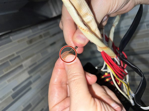

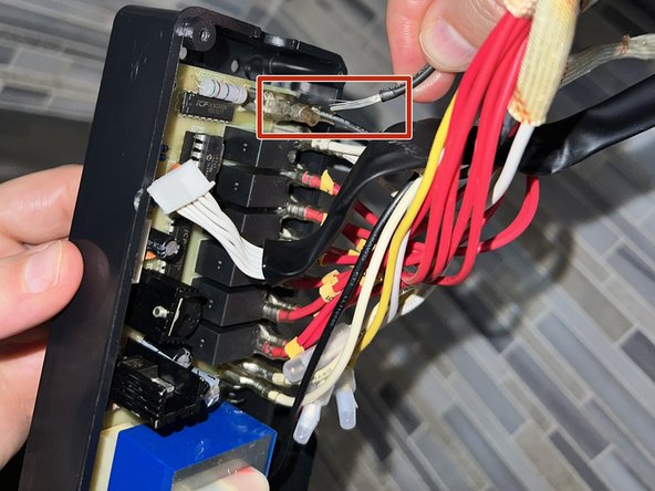

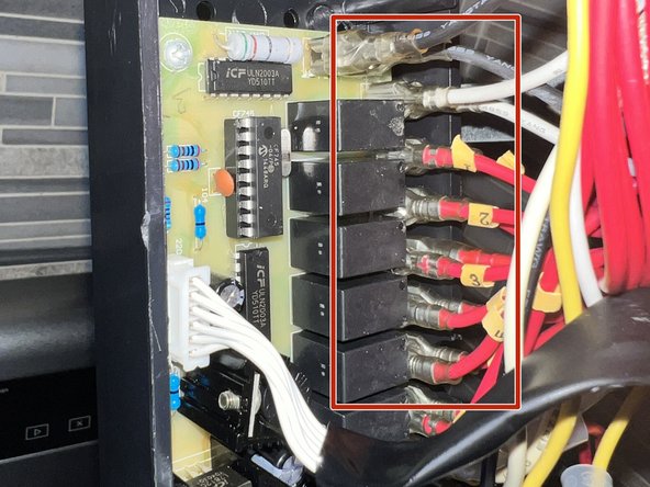

  6. Cyclone Range Hood (Model CY3000R) Circuit Board Replacement: crwdns2935265:06crwdnd2935265:01crwdnd2935265:03crwdne2935265:0 Cyclone Range Hood (Model CY3000R) Circuit Board Replacement: crwdns2935265:06crwdnd2935265:02crwdnd2935265:03crwdne2935265:0 Cyclone Range Hood (Model CY3000R) Circuit Board Replacement: crwdns2935265:06crwdnd2935265:03crwdnd2935265:03crwdne2935265:0
    • Insert the tips of the wires into the board's protective plastic that comes with your replacement board.
    • To reinsert the wires, insert the two black wires into the first two slots on the top.
    • The second row is for the white wires, which can be attached in any order; for the remaining red wires, adhere to the ordered numbers attached to the wires.

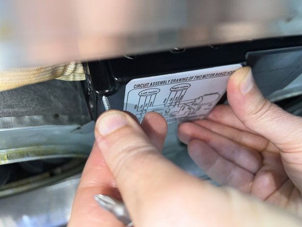

  7. Cyclone Range Hood (Model CY3000R) Circuit Board Replacement: crwdns2935265:07crwdnd2935265:01crwdnd2935265:03crwdne2935265:0 Cyclone Range Hood (Model CY3000R) Circuit Board Replacement: crwdns2935265:07crwdnd2935265:02crwdnd2935265:03crwdne2935265:0 Cyclone Range Hood (Model CY3000R) Circuit Board Replacement: crwdns2935265:07crwdnd2935265:03crwdnd2935265:03crwdne2935265:0
    • Replace the lid.
    • Reinstall the four 5 mm Phillips #1 screws to secure the lid.
    • Shut the panel.
