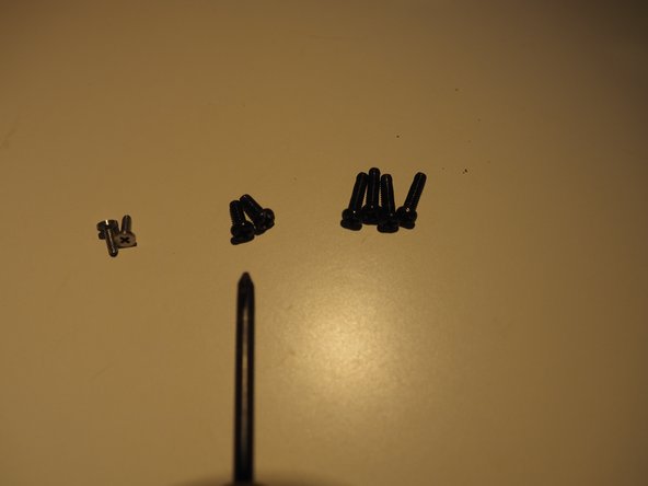

      • Remove the 2 silver screws from the black cover
      • Remove the 4 black screws from the camera housing
      • Remove the 2 screws holding the battery into the case. One is tight so you'll need to rotate the camera without pulling the wires too much

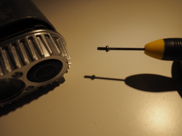

      • Remove the single black screw from the back

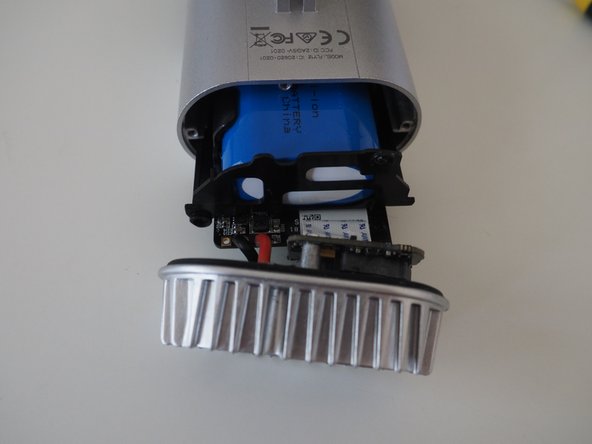

    3. Cycliq Fly 12 Battery Replacement, Push the board out: crwdns2935265:03crwdnd2935265:01crwdnd2935265:02crwdne2935265:0 Cycliq Fly 12 Battery Replacement, Push the board out: crwdns2935265:03crwdnd2935265:02crwdnd2935265:02crwdne2935265:0
      • Carefully push through the slot above the SD card (NOT the slot I'm showing!). If you have to push hard you've probably forgotten to remove a screw. Use a match stick if you can because you are pushing on a piece of tape and don't want to tear it.
      • Push until you can grab the battery from the front and pull it.

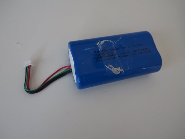

    4. Cycliq Fly 12 Battery Replacement, Remove the battery: crwdns2935265:04crwdnd2935265:01crwdnd2935265:02crwdne2935265:0 Cycliq Fly 12 Battery Replacement, Remove the battery: crwdns2935265:04crwdnd2935265:02crwdnd2935265:02crwdne2935265:0
      • The blue battery pack is taped in. Remove it. Save the foam and double sided tape.
      • Make a note of plug orientation (maybe mark with a pen), then unplug the white clip from the board.

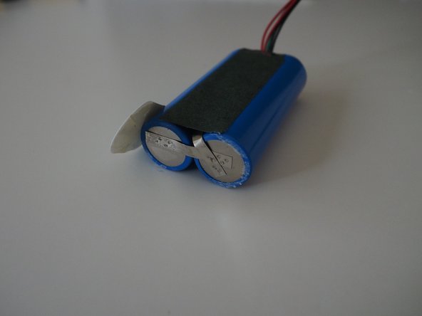

      • Cut the blue plastic holding the batteries together, and peel it off to reveal the black strip shown in the second pic. You'll want to keep the black strip.
    6. Cycliq Fly 12 Battery Replacement, Remove the voltage regulator and keep it for the new battery: crwdns2935265:06crwdnd2935265:01crwdnd2935265:02crwdne2935265:0 Cycliq Fly 12 Battery Replacement, Remove the voltage regulator and keep it for the new battery: crwdns2935265:06crwdnd2935265:02crwdnd2935265:02crwdne2935265:0
      • Remove the strip of black tape to reveal the voltage regulator.
      • Notice how the batteries are soldered in parallel - "+ve to +ve" and "-ve to -ve". The batteries have a ridge on the +ve end. The board goes close to the +ve end with the lip.
      • Remove the voltage regulator and its attached wires. Keep it because you'll solder to the new batteries.
    7. Cycliq Fly 12 Battery Replacement, Solder the new batteries and join with tape: crwdns2935265:07crwdnd2935265:01crwdnd2935265:03crwdne2935265:0 Cycliq Fly 12 Battery Replacement, Solder the new batteries and join with tape: crwdns2935265:07crwdnd2935265:02crwdnd2935265:03crwdne2935265:0 Cycliq Fly 12 Battery Replacement, Solder the new batteries and join with tape: crwdns2935265:07crwdnd2935265:03crwdnd2935265:03crwdne2935265:0
      • Use the battery tabs to solder the two batteries together. The tolerances around the battery pack are tight, so keep the overlaps and solder to a minimum. You solder the negative to negative so the batteries are in parallel. Take a look at the batteries and you'll see they have an indent on the body at one end.
      • Solder the voltage regulator board between the batteries. Be careful not to heat the batteries too much.
      • I used tape on the two ends of the batteries, but a heat shrink tube would work better.
