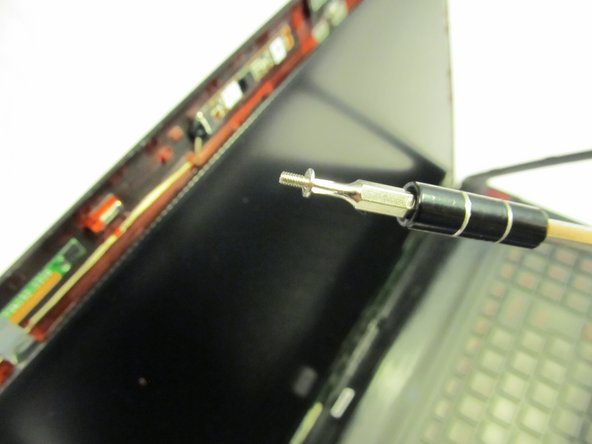

  3. CyberpowerPC Fangbook HX6 Screen Replacement: crwdns2935265:03crwdnd2935265:01crwdnd2935265:02crwdne2935265:0 CyberpowerPC Fangbook HX6 Screen Replacement: crwdns2935265:03crwdnd2935265:02crwdnd2935265:02crwdne2935265:0
    • Remove the two 4mm silver screws on both sides of the top of the screen.
    • Once you have removed them, gently pull the screen off of the aligning dials (the small plastic pieces to the left of the screws).

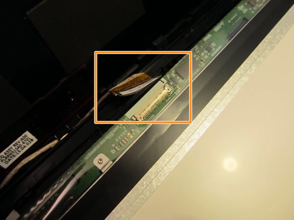

  4. CyberpowerPC Fangbook HX6 Screen Replacement: crwdns2935265:04crwdnd2935265:01crwdnd2935265:02crwdne2935265:0 CyberpowerPC Fangbook HX6 Screen Replacement: crwdns2935265:04crwdnd2935265:02crwdnd2935265:02crwdne2935265:0
    • At this point the only thing keeping the screen attached to the laptop is this small wire and connector shown here.
    • Gently pull the screen out and turn it over so that you can see where the connector is attached.
    • Carefully remove it. Once this is done you have successfully removed the screen from your laptop.
