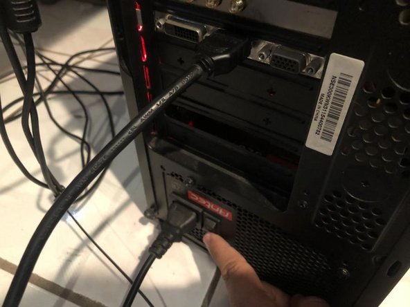

    • Before doing anything, you must be sure that the computer itself is off so no damage or loss of data can be made to the computer.
    • Turn the computer around and turn the power switch from "I" (on) to "O" (off).
    • Remove the power cable from its outlet and disconnect any peripherals (microphone, webcam, etc.).

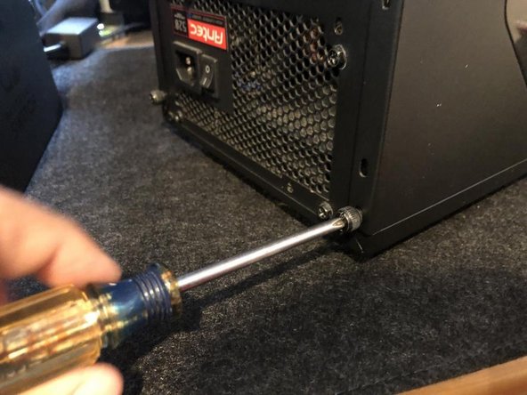

    • Place the computer on a table.
    • Remove the screws holding the side panel with a screwdriver.
    • Slide the side panel from right to left to open the computer and see its components.
    • Place the side panel somewhere else to keep the area clear, and set the computer down on its side, where the open side is up for you to work.
