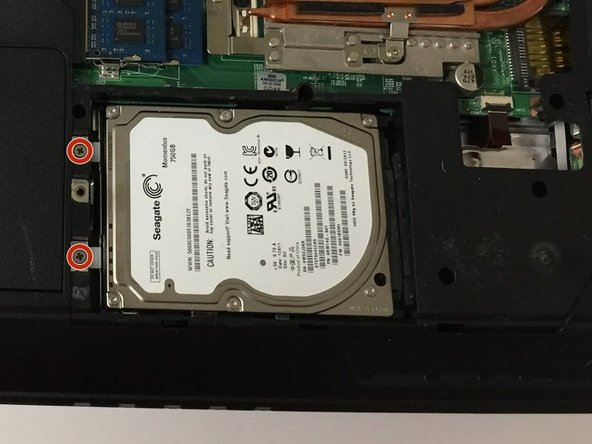

  3. CyberPowerPC Fangbook MS-1763 Hard Drive Replacement, Hard Drive: crwdns2935265:03crwdnd2935265:01crwdnd2935265:03crwdne2935265:0 CyberPowerPC Fangbook MS-1763 Hard Drive Replacement, Hard Drive: crwdns2935265:03crwdnd2935265:02crwdnd2935265:03crwdne2935265:0 CyberPowerPC Fangbook MS-1763 Hard Drive Replacement, Hard Drive: crwdns2935265:03crwdnd2935265:03crwdnd2935265:03crwdne2935265:0
    • Locate the hard drive on the inside of the computer. First Image shows it outlined in red.
    • Remove the two screws holding the hard drive in place. Keep these on the side.
    • Screws are silver in color, both same length.

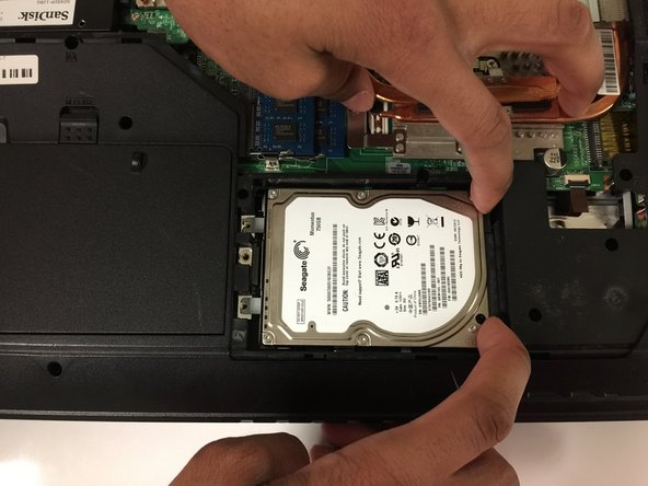

  4. CyberPowerPC Fangbook MS-1763 Hard Drive Replacement: crwdns2935265:04crwdnd2935265:01crwdnd2935265:02crwdne2935265:0 CyberPowerPC Fangbook MS-1763 Hard Drive Replacement: crwdns2935265:04crwdnd2935265:02crwdnd2935265:02crwdne2935265:0
    • Before we can remove the hard drive, we must first disconnect it from it's connectors. These are on the opposite side of the screws.
    • To disconnect them, we push the hard drive out of the slots. Grip the sides, and push (or pull) towards the screws. The hard drive should move slightly.
  5. CyberPowerPC Fangbook MS-1763 Hard Drive Replacement: crwdns2935265:05crwdnd2935265:01crwdnd2935265:01crwdne2935265:0
    • With the hard drive screws removed, and disconnected from the computer - we can remove it.
    • Lift up on the small tag in between the mounts we removed the screws from. You might have to move the hard drive slightly to keep the screw mounts from getting stuck. This is normal.
    • Note the orientation of the hard drive. You'll need to insert the new one in the same exact position, to line up the connectors.
To install the new hard drive, follow the steps in reverse. Ensure the new hard drive is oriented the same as the old one. Only difference is to push the hard drive into the connectors.
