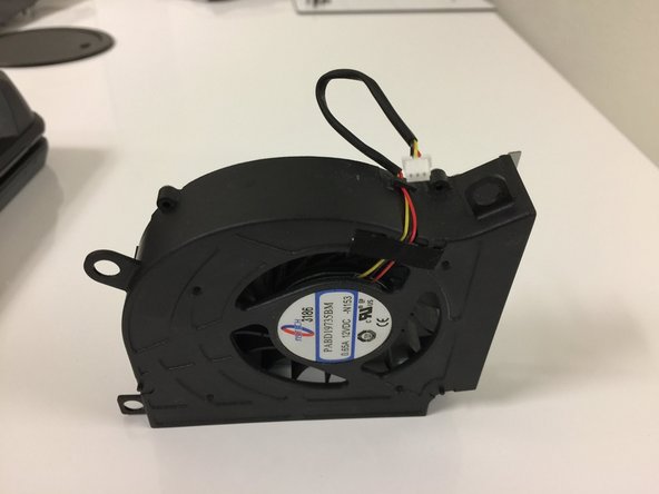

  3. CyberPowerPC Fangbook MS-1763 CPU Fan Replacement, CPU Fan: crwdns2935265:03crwdnd2935265:01crwdnd2935265:01crwdne2935265:0
    • Locate the CPU Fan inside the computer. It is outlined in red.
  4. CyberPowerPC Fangbook MS-1763 CPU Fan Replacement: crwdns2935265:04crwdnd2935265:01crwdnd2935265:02crwdne2935265:0 CyberPowerPC Fangbook MS-1763 CPU Fan Replacement: crwdns2935265:04crwdnd2935265:02crwdnd2935265:02crwdne2935265:0
    • Locate the screws holding the fan in place. There are four mounts where they could be.
    • Use a Phillips Head #00-01 to remove them.
  5. CyberPowerPC Fangbook MS-1763 CPU Fan Replacement: crwdns2935265:05crwdnd2935265:01crwdnd2935265:02crwdne2935265:0 CyberPowerPC Fangbook MS-1763 CPU Fan Replacement: crwdns2935265:05crwdnd2935265:02crwdnd2935265:02crwdne2935265:0
    • Once all screws are removed, lift up on the fan.
    • There should be a plug connecting the fan to the laptop. Gently pull up on this plug to remove it.
    • Note the orientation of the plug. It has to be inserted into the connector the same way.
