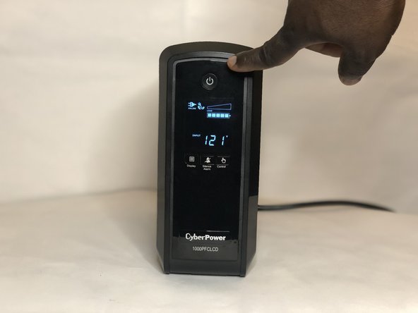

  1. CyberPower UPS Battery Replacement, Battery: crwdns2935265:01crwdnd2935265:01crwdnd2935265:02crwdne2935265:0 CyberPower UPS Battery Replacement, Battery: crwdns2935265:01crwdnd2935265:02crwdnd2935265:02crwdne2935265:0
    • Power down the unit by pressing the power button until the display goes black.
    • This is usually about 3 seconds.
    • Unplug the power cord from the wall outlet.

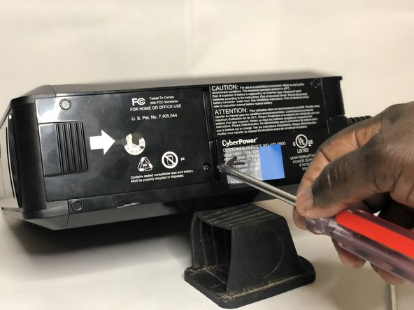

  2. CyberPower UPS Battery Replacement: crwdns2935265:02crwdnd2935265:01crwdnd2935265:03crwdne2935265:0 CyberPower UPS Battery Replacement: crwdns2935265:02crwdnd2935265:02crwdnd2935265:03crwdne2935265:0 CyberPower UPS Battery Replacement: crwdns2935265:02crwdnd2935265:03crwdnd2935265:03crwdne2935265:0
    • Remove the battery plate cover at the bottom of the UPS using a Phillips #1 screwdriver.
    • If the screwdriver is not magnetized, tap on the cover plate to completely remove the screw.

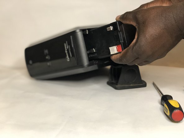

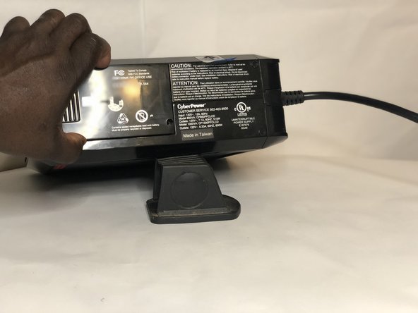

  3. CyberPower UPS Battery Replacement: crwdns2935265:03crwdnd2935265:01crwdnd2935265:02crwdne2935265:0 CyberPower UPS Battery Replacement: crwdns2935265:03crwdnd2935265:02crwdnd2935265:02crwdne2935265:0
    • Slide the battery cover plate to the left.
    • Grasp the battery plate cover and lift it off the the UPS.

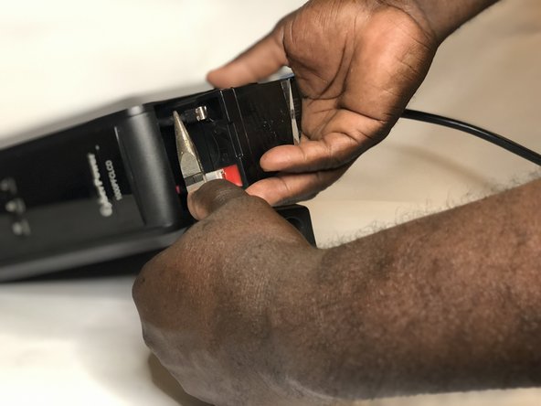

  4. CyberPower UPS Battery Replacement: crwdns2935265:04crwdnd2935265:01crwdnd2935265:03crwdne2935265:0 CyberPower UPS Battery Replacement: crwdns2935265:04crwdnd2935265:02crwdnd2935265:03crwdne2935265:0 CyberPower UPS Battery Replacement: crwdns2935265:04crwdnd2935265:03crwdnd2935265:03crwdne2935265:0
    • Pull out the battery to expose the terminal connectors.
    • Use needlenose pliers to disconnect both battery terminal connectors.
    • Do not pull the connectors by the wires, pull connectors by grabbing the connector itself.
    • With the battery terminal connectors disconnected, slide the battery all the way out.

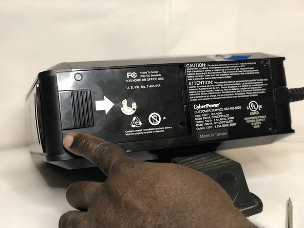

  5. CyberPower UPS Battery Replacement: crwdns2935265:05crwdnd2935265:01crwdnd2935265:03crwdne2935265:0 CyberPower UPS Battery Replacement: crwdns2935265:05crwdnd2935265:02crwdnd2935265:03crwdne2935265:0 CyberPower UPS Battery Replacement: crwdns2935265:05crwdnd2935265:03crwdnd2935265:03crwdne2935265:0
    • The replacement battery should be a 12 volt, 9 amp-hour, sealed lead acid battery with f2 type connectors.
    • Install the new battery and reconnect the terminals.

  7. CyberPower UPS Battery Replacement: crwdns2935265:07crwdnd2935265:01crwdnd2935265:03crwdne2935265:0 CyberPower UPS Battery Replacement: crwdns2935265:07crwdnd2935265:02crwdnd2935265:03crwdne2935265:0 CyberPower UPS Battery Replacement: crwdns2935265:07crwdnd2935265:03crwdnd2935265:03crwdne2935265:0
    • Plug system into the wall outlet.
    • Press the power button to turn on the unit.
