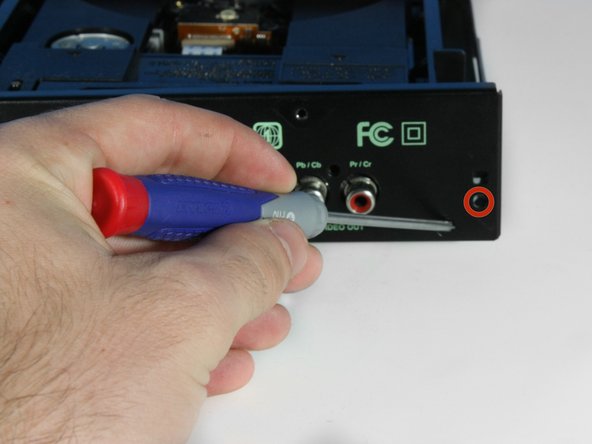

    • Locate the 15mm Phillips screws on the left side (1 screw), right side (1 screw), and back (4 screws) of the DVD Player. Use the appropriate Phillips head screwdriver to remove the six screws.

    • Remove the remaining screws on the back of the DVD player:
    • There will be four 15 mm screws and two 6.3 mm screws.

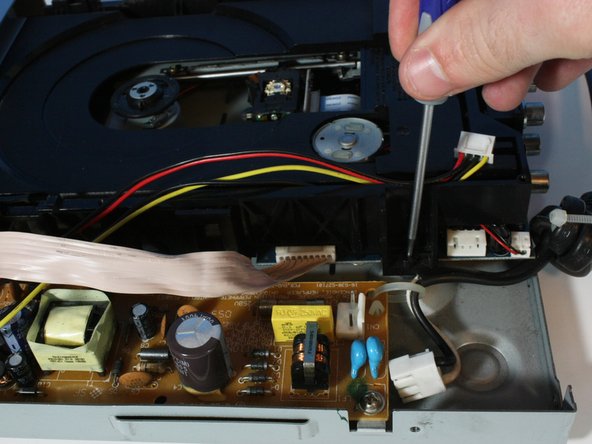

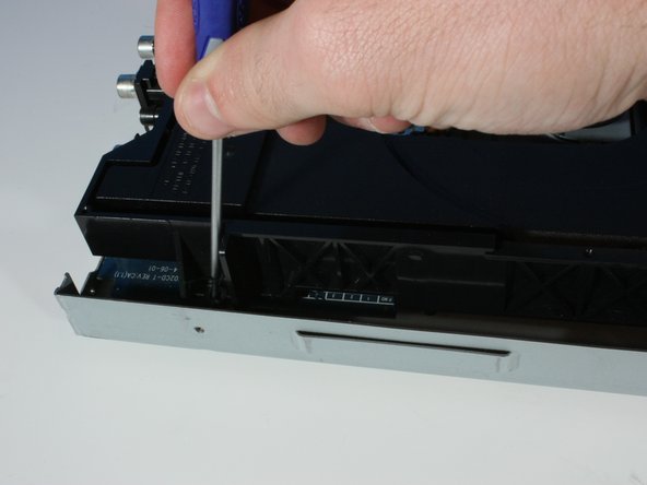

    • Remove the four 8.1mm screws in each of the corners of the disc tray.

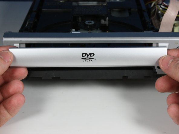

    • Orient the device so the front is facing towards you. Remove the disc tray faceplate by lifting up on both corners firmly.
    • The faceplate is located on the front of the DVD player and will prevent the disc tray removal if not removed.

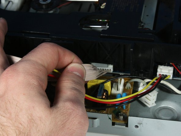

    • Detach the ribbon cable from the side of the DVD player by gently pulling it out.
