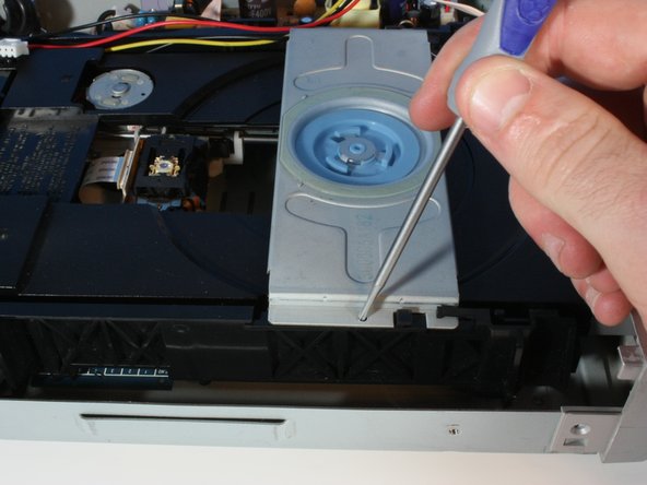

  3. CyberHome CH-DVD 300 Disc Tray Bracket Replacement, Disc Tray Bracket: crwdns2935265:03crwdnd2935265:01crwdnd2935265:02crwdne2935265:0 CyberHome CH-DVD 300 Disc Tray Bracket Replacement, Disc Tray Bracket: crwdns2935265:03crwdnd2935265:02crwdnd2935265:02crwdne2935265:0
    • Remove the 6.3mm screws keeping the disc tray bracket connected to the disc tray.
  4. CyberHome CH-DVD 300 Disc Tray Bracket Replacement: crwdns2935265:04crwdnd2935265:01crwdnd2935265:02crwdne2935265:0 CyberHome CH-DVD 300 Disc Tray Bracket Replacement: crwdns2935265:04crwdnd2935265:02crwdnd2935265:02crwdne2935265:0
    • Lift up on the bracket by:
    • Sliding the disc tray bracket forward.
    • Lifting the back edge up.
