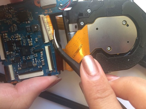

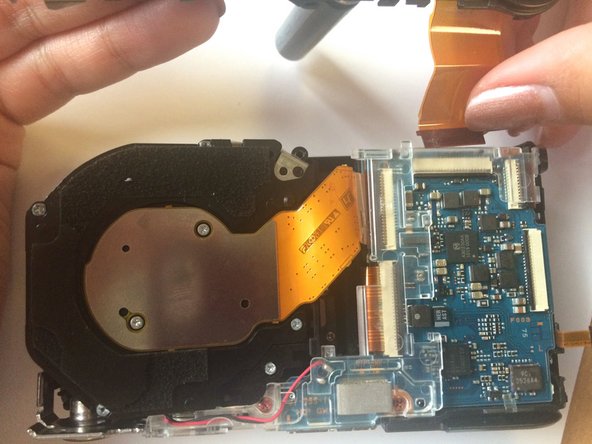

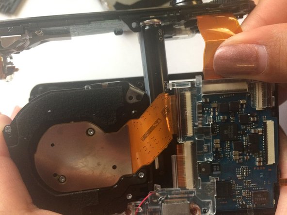

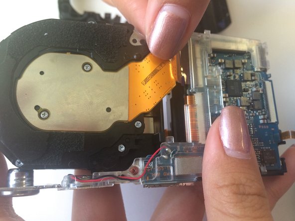

  11. Cyber-shot DSC-H55 Lens Replacement, Removing Ribbon Wires around Lens: crwdns2935265:011crwdnd2935265:01crwdnd2935265:03crwdne2935265:0 Cyber-shot DSC-H55 Lens Replacement, Removing Ribbon Wires around Lens: crwdns2935265:011crwdnd2935265:02crwdnd2935265:03crwdne2935265:0 Cyber-shot DSC-H55 Lens Replacement, Removing Ribbon Wires around Lens: crwdns2935265:011crwdnd2935265:03crwdnd2935265:03crwdne2935265:0
    • Remove the two orange screws located under the lens.
    • Remove the plastic by grabbing the right side of the camera and pushing it away in order for the plastic to come out.
    • By removing the plastic, we can now easily remove the ribbon wires by lifting the black clip and sliding ribbon wire out. Use tweezers if necessary.
  12. Cyber-shot DSC-H55 Lens Replacement, Remove Lens: crwdns2935265:012crwdnd2935265:01crwdnd2935265:02crwdne2935265:0 Cyber-shot DSC-H55 Lens Replacement, Remove Lens: crwdns2935265:012crwdnd2935265:02crwdnd2935265:02crwdne2935265:0
    • Once the ribbons are detached, the lens is now completely detached from camera and can be replaced.
