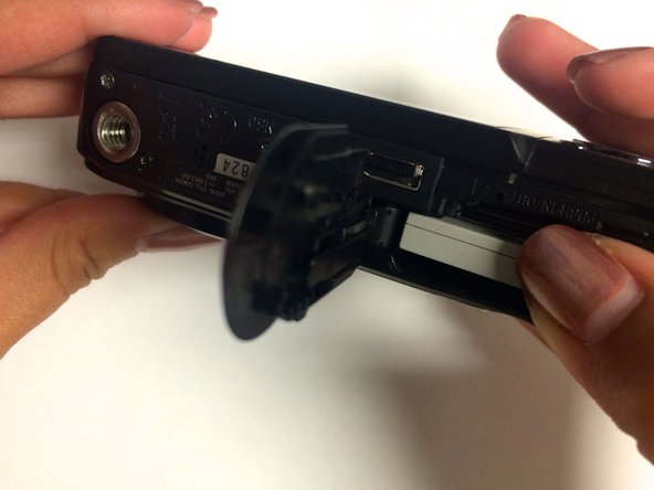

  2. Cyber-Shot DSC-H55 Battery Replacement, Opening Battery Compartment: crwdns2935265:02crwdnd2935265:01crwdnd2935265:03crwdne2935265:0 Cyber-Shot DSC-H55 Battery Replacement, Opening Battery Compartment: crwdns2935265:02crwdnd2935265:02crwdnd2935265:03crwdne2935265:0 Cyber-Shot DSC-H55 Battery Replacement, Opening Battery Compartment: crwdns2935265:02crwdnd2935265:03crwdnd2935265:03crwdne2935265:0
    • Grab the camera with one hand, with your thumb still on the lid, apply pressure and slide to the right.
    • Lift the lid, exposing the battery and SD slot.
