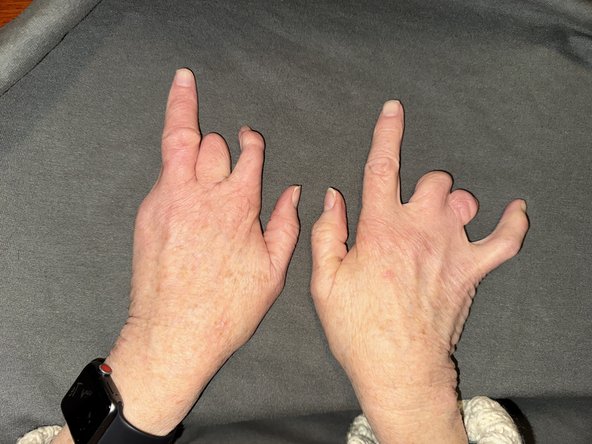

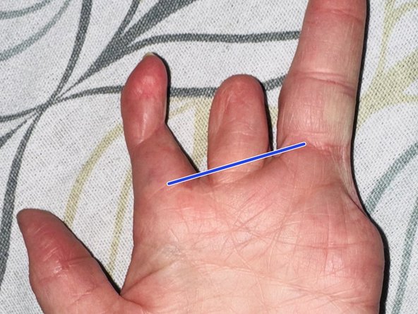

    • These are my hands. There are four issues:
    • I am missing my left pinky finger
    • The middle two fingers on my left hand are webbed together to the first knuckle
    • Four of my fingers are short (they all have every bone, but they are stunted).
    • On my left hand, the webbing between the index finger and the middle finger was removed so the fingers separation point is lower than normal.

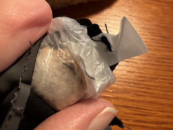

  3. Custom fit waterproof winter gloves, Glove Anatomy: crwdns2935265:03crwdnd2935265:01crwdnd2935265:01crwdne2935265:0
    • The fabric strips between the fingers are called fourchettes (see https://en.wikipedia.org/wiki/Glove for a description). So the gloves have a front, back and the fourchettes. Some gloves use a single fourchette running between all the fingers and the tips of fingers, like the equestrian gloves I modified to fit, shown here.
    • Winter gloves often have a separate lining, which could be fleece or knitted fabric. Effectively this means there are two gloves, one inside the other.
    • The surprising fact about the winter gloves I am modifying here is that they also have a plastic bag between the two layers. At the end of each finger, there's a plastic tab that goes through the plastic bag to connect the finger tip of the inner glove to the finger tip of the outer glove.

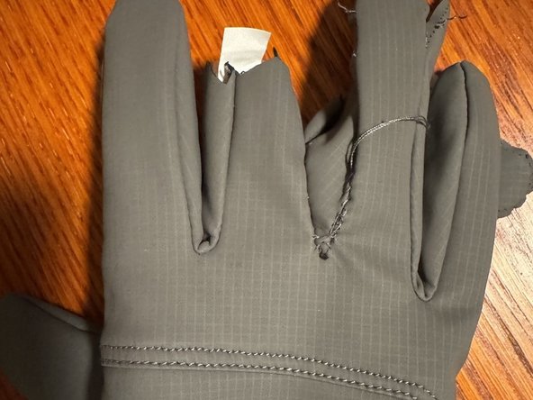

    • Start by carefully unpicking the side seam of a finger you need to shorten. Use your seam ripper, and be careful not to cut anything other than the thread.
    • Unpick the fourchette between webbed fingers.
    • Unpick most of the stitches for the missing left pinky finger. We will use the fourchette that ran between the pinky and ring fingers to cover the gap.
    • Unpick the plastic tab that connects the plastic bag to the outer glove finger tips
    • DON'T cut off any fabric yet!

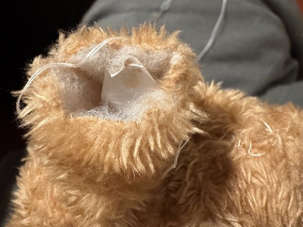

  5. Custom fit waterproof winter gloves, Unpick the Inner Glove: crwdns2935265:05crwdnd2935265:01crwdnd2935265:01crwdne2935265:0
    • The inner glove of these gloves is made of soft knit fake fur, which stretches more than the outer glove. It doesn't use fourchettes because the fabric has more give.
    • Carefully turn each glove inside-out. and repeat the steps for the outer glove:
    • Unpick the fingers that need to be shortened.
    • Unpick the stitches between the webbed fingers.
    • Unpick the plastic tab that connected the plastic bag to the inner glove.
    • DON'T cut any fabric yet!

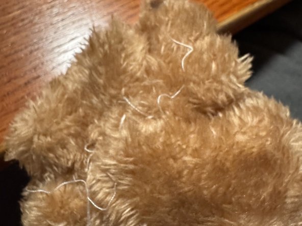

    • We opened up the inner glove to accommodate the webbing between the fingers on the right hand, but there isn't enough fabric to close the inner glove without making some changes.
    • With the glove inside-out, use some of the lining fabric from the left pinky to fill the gap. As before, use whip-stitch with a 3mm (1/8") seam allowance, and web those fingers.

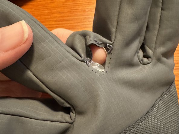

  10. Custom fit waterproof winter gloves, Outer Glove: webbed fingers: crwdns2935265:010crwdnd2935265:01crwdnd2935265:02crwdne2935265:0 Custom fit waterproof winter gloves, Outer Glove: webbed fingers: crwdns2935265:010crwdnd2935265:02crwdnd2935265:02crwdne2935265:0
    • Use a small scrap of fabric from the missing pinky to fill in the gap between the webbed fingers. I also used a small plastic card to avoid putting the sewing needle through the plastic bag.
    • Use whip-stitch (or backstitch if you can manage it) with a 3mm (1/8") seam allowance.
    • Repeat front and back.

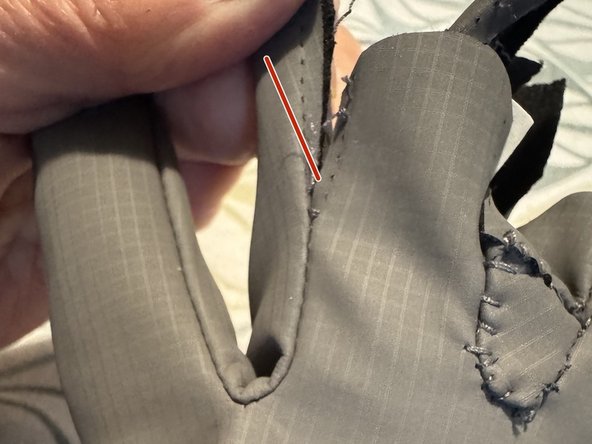

  11. Custom fit waterproof winter gloves, Outer Gloves - short fingers: crwdns2935265:011crwdnd2935265:01crwdnd2935265:02crwdne2935265:0 Custom fit waterproof winter gloves, Outer Gloves - short fingers: crwdns2935265:011crwdnd2935265:02crwdnd2935265:02crwdne2935265:0
    • Carefully trim the fingers to the right length, allowing seam allowance. Again, too long is better than too short; you can always unpick and redo if needed.
    • The fourchettes will need to be trimmed to form triangle shapes. The front and back of the gloves are slightly rounded and will meet in at the tip. The red line in the second image shows where to cut the fourchette (fold it in half vertically then cut).
    • If the gloves you are modifying have a fourchette that runs in one long strip between all the fingers, you may want to use this approach anyway to avoid unpicking the whole length or creating a seam at the tip of the fingers.
    • Sew the plastic tab to the tip of finger (front or back), and push the plastic bag into the glove a bit so it's less likely to get in the way.
    • Carefully sew the fourchettes to the front and back of the glove, and sew the tips together. I used whip-stitch with a 3mm (1/8") seam allowance.
