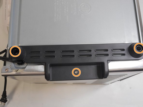

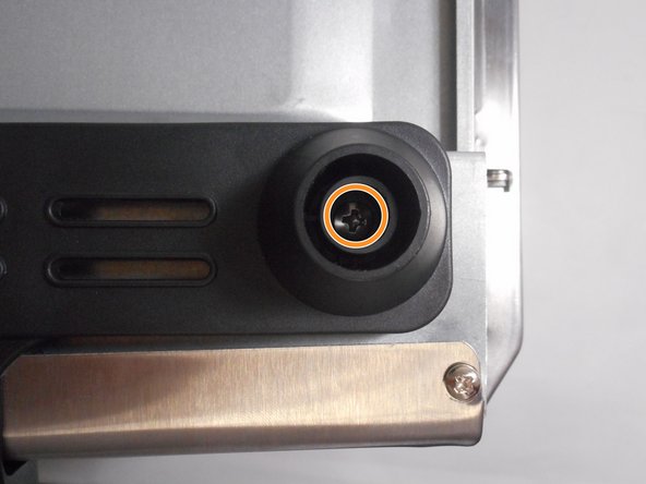

    • Flip the oven upside down.
    • Use a spudger to pull out the grey stoppers.
    • Use a Phillips #1 screwdriver to remove all three 11 mm screws.

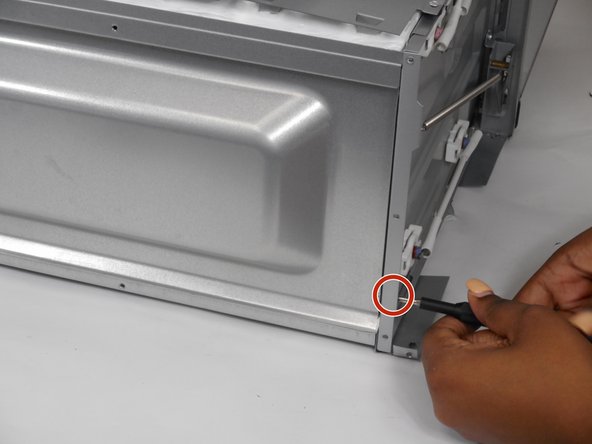

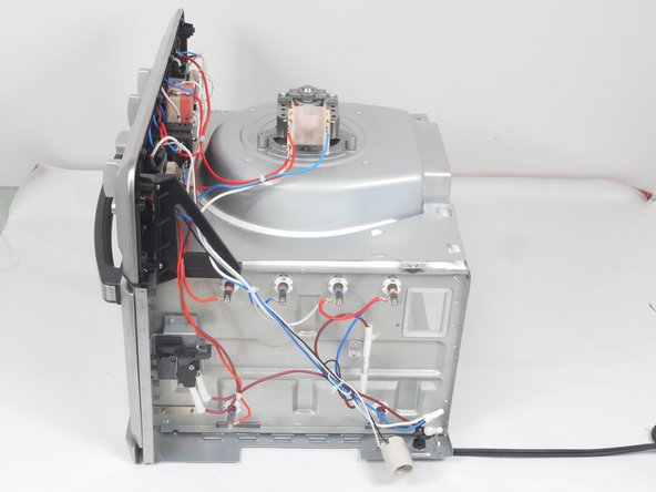

  4. Cuisinart TOA-60FR Lightbulb Replacement: crwdns2935265:04crwdnd2935265:01crwdnd2935265:02crwdne2935265:0 Cuisinart TOA-60FR Lightbulb Replacement: crwdns2935265:04crwdnd2935265:02crwdnd2935265:02crwdne2935265:0
    • Unscrew all of the 11.05 mm screws that connect the outer shell to the interior device.

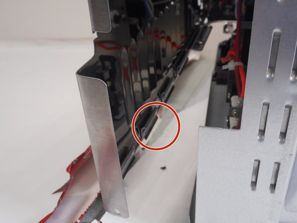

  5. Cuisinart TOA-60FR Lightbulb Replacement: crwdns2935265:05crwdnd2935265:01crwdnd2935265:03crwdne2935265:0 Cuisinart TOA-60FR Lightbulb Replacement: crwdns2935265:05crwdnd2935265:02crwdnd2935265:03crwdne2935265:0 Cuisinart TOA-60FR Lightbulb Replacement: crwdns2935265:05crwdnd2935265:03crwdnd2935265:03crwdne2935265:0
    • Push down with a screw driver between the tabs, then pull up to release the tabs. Pull the top piece off.

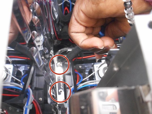

  6. Cuisinart TOA-60FR Lightbulb Replacement, Lightbulb: crwdns2935265:06crwdnd2935265:01crwdnd2935265:02crwdne2935265:0 Cuisinart TOA-60FR Lightbulb Replacement, Lightbulb: crwdns2935265:06crwdnd2935265:02crwdnd2935265:02crwdne2935265:0
    • Remove these two 12.8 mm screws at the top on each side.
    • Remove two 12.8 mm screws at the bottom, as demonstrated in the first picture.
    • You should now be able to push the back out with the four screws removed to see the light bulb.

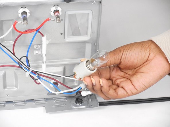

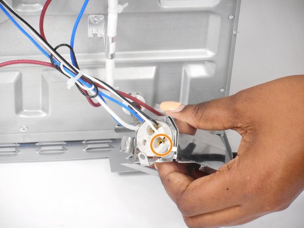

  7. Cuisinart TOA-60FR Lightbulb Replacement: crwdns2935265:07crwdnd2935265:01crwdnd2935265:01crwdne2935265:0
    • Remove these four screws.
    • Pull the light away from it's window.
  8. Cuisinart TOA-60FR Lightbulb Replacement: crwdns2935265:08crwdnd2935265:01crwdnd2935265:02crwdne2935265:0 Cuisinart TOA-60FR Lightbulb Replacement: crwdns2935265:08crwdnd2935265:02crwdnd2935265:02crwdne2935265:0
    • Using a wrench, remove the washer.
    • Pull the silver casing off the lightbulb.
  9. Cuisinart TOA-60FR Lightbulb Replacement: crwdns2935265:09crwdnd2935265:01crwdnd2935265:02crwdne2935265:0 Cuisinart TOA-60FR Lightbulb Replacement: crwdns2935265:09crwdnd2935265:02crwdnd2935265:02crwdne2935265:0
    • Now unscrew the lightbulb to replace it with a new one.
