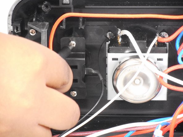

    • Push down with a screw driver between the tabs, then pull up to release the tabs. Pull the top piece off.
  6. Cuisinart TOA-60FR Light Switch Spring Replacement, Light Switch Spring: crwdns2935265:06crwdnd2935265:01crwdnd2935265:02crwdne2935265:0 Cuisinart TOA-60FR Light Switch Spring Replacement, Light Switch Spring: crwdns2935265:06crwdnd2935265:02crwdnd2935265:02crwdne2935265:0

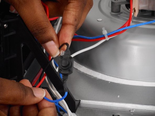

    • Unscrew these two screws to detach the light switch from the panel.
  7. Cuisinart TOA-60FR Light Switch Spring Replacement: crwdns2935265:07crwdnd2935265:01crwdnd2935265:02crwdne2935265:0 Cuisinart TOA-60FR Light Switch Spring Replacement: crwdns2935265:07crwdnd2935265:02crwdnd2935265:02crwdne2935265:0

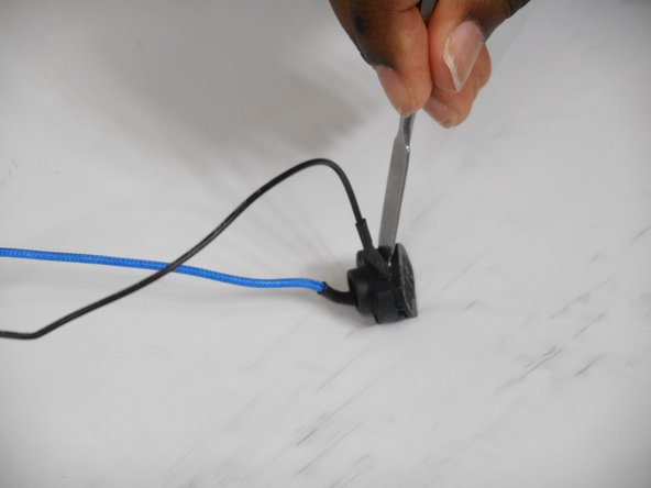

  8. Cuisinart TOA-60FR Light Switch Spring Replacement: crwdns2935265:08crwdnd2935265:01crwdnd2935265:02crwdne2935265:0 Cuisinart TOA-60FR Light Switch Spring Replacement: crwdns2935265:08crwdnd2935265:02crwdnd2935265:02crwdne2935265:0
    • Use a metal spudger to pry open the clicking piece.
  9. Cuisinart TOA-60FR Light Switch Spring Replacement: crwdns2935265:09crwdnd2935265:01crwdnd2935265:01crwdne2935265:0
    • Remove the broken spring and replace it with the new one.
